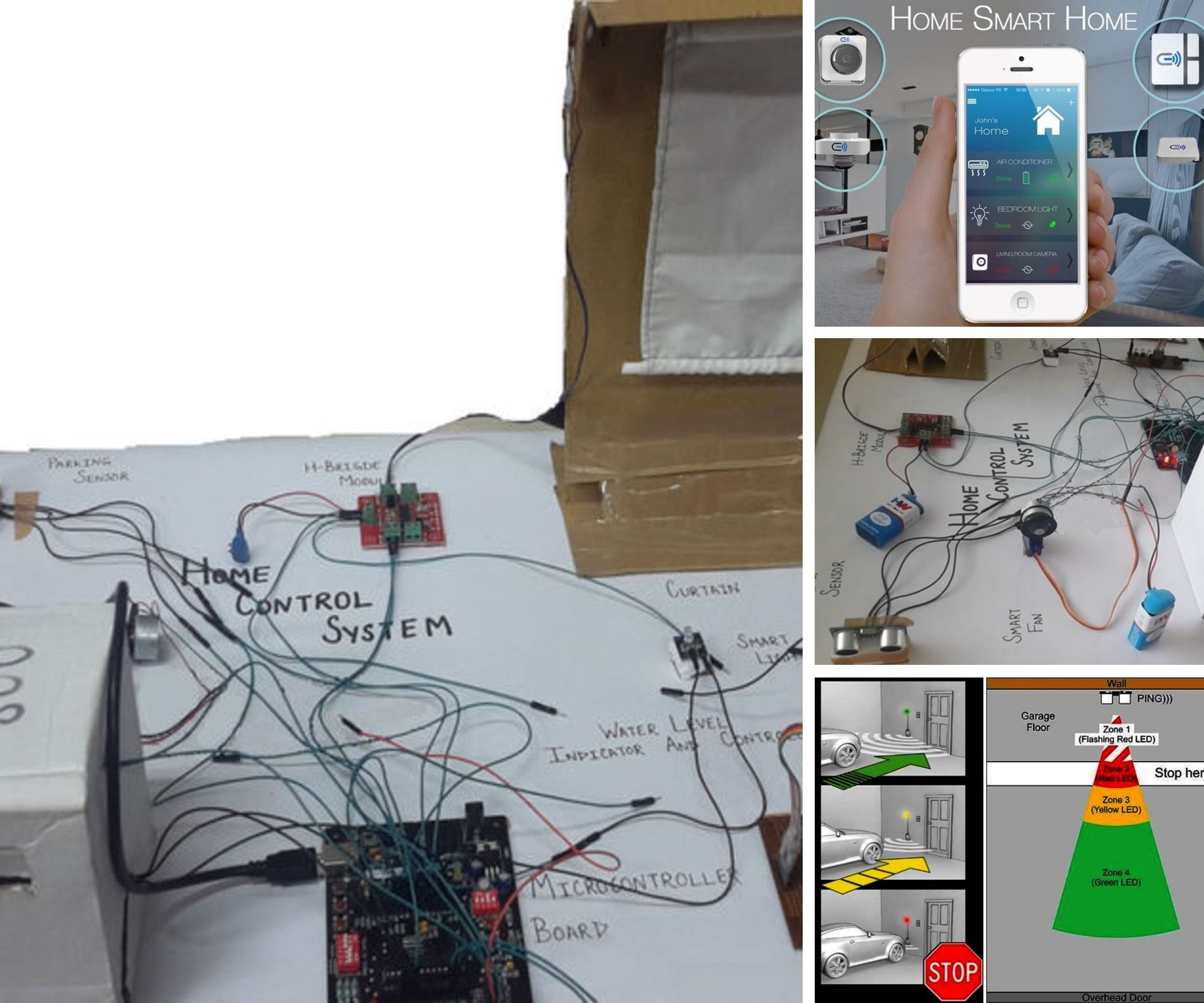

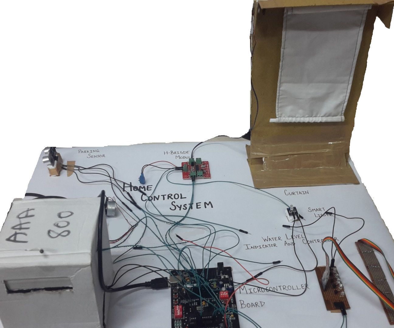

Step 2: Connections
Do the connections as shown in the figure.
- The Rx of arduino is connected to the Tx of GSM and the Tx of arduino is connected with the Rx of GSM.
- The relays are connected with the digital pins.
