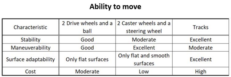

1. Ability to move
This product’s mobility is achieved through contact with the ground, primarily facilitated by a mechanical wheel system. The robot will navigate across various types of flooring, including tiles, carpets, and parquet flooring, and must adapt its movement despite changes in the ground material. To achieve this, it must maintain an effective contact surface with the ground. Different combinations of wheels can fulfill this function.
Below the characteristic to take into account when comparing the different wheel combination by order of importance of the different characteristic.
  • Stability: A stable robot is less likely to get stuck or to lose balance and thus interrupt its work.
  • Cost: The cost of the components is still an important part of the project.
  • Maneuverability: When avoiding obstacles, moving alongside the walls, cleaning a corner or even following a path.
  • Surface adaptability: A home hoover will likely encounter different types of floors and will need to be able to move on it.
According to this table and order of importance of the characteristic of comparison, using two drive wheels and a ball is the most suitable solution in our case.

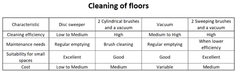

2. Cleaning of floors
The floor cleaning function offers a wide range of options, depending on the type of floor to be cleaned and the level of efficiency required. So it’s important to choose the right cleaning system for the job.
Below the characteristic to take into account when comparing the different cleaning tools by order of importance and a comparative table of the different characteristic.
  • Cleaning efficiency: The primary purpose of the home hoover is to clean, the cleaning efficiency is thus the highest priority
  • Maintenance needs: For an automated home hoover, the robot need to be able to operate without constant supervision. It is thus important that the robot is low maintenance.
  • Suitability for small spaces: A robot that don’t take much space and thus cleaning tools that are compact is essential to be able to clean everywhere.
Figure: Cleaning of floors
According to this table and order of importance of the characteristic of comparison, using the two sweeping brushes and a vacuum is the most suitable solution in our case

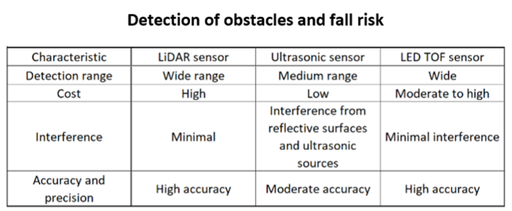

4. Detection of obstacles and fall risk
In order to move as required, the robot must detect whether or not there is an obstacle or a risk to fall. The detection is done by sensors mounted at the front and sides of the robot. One of the sensor at the front is slightly oriented to the floor to detect if there is a floor the other one detect if there is an obstacle in front. If it detects an obstacle or it fails to detect a floor, it will avoid the area concerned. The sensors on the sides detect if there is an obstacle and if it’s free to turn.
Below the characteristic to take into account when comparing the different distance sensor by order of importance and a comparative table of the different characteristic.
  • Detection range: It’s the most important characteristic in obstacle detection. With a too low detection range, the sensor is not going to detect anything.
  • Interference: If there is too much interference the sensor is not going to be reliable
  • Accuracy and precision: Determine how reliable is the sensor, it is important to avoid false positive or negative.
Figure: Detection of obstacles and fall risk
According to this table and order of importance of the characteristic of comparison, using the ultrasonic sensor is the most suitable solution in our case.

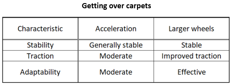

5. Getting over carpets
The robot must be able to access all cleanable areas, including carpets. For that it would need a way to climb on it and thus overcome the thickness of the carpet.
Below the characteristic to take into account when comparing the different way to go over carpets by order of importance and a comparative table of the different characteristic.
  • Stability: Stability is really important in the case of an automated home hoover. To stay as independent as possible the robot need to stay operational and don’t tip over.
  • Traction: To go over carpet, the robot is going to need a good traction to maintain control and don’t slip.
  • Adaptability: The robot is going to go through different types of floor, it needs to adapted to different texture.
Figure: Getting over carpets
According to this table and order of importance of the characteristic of comparison, using larger wheels is the most suitable solution in our case

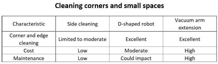

7. Cleaning corners and small spaces
To be truly effective, the robot will need to be able to clean more difficult areas, such as corners and small spaces.
Below the characteristic to take into account when comparing the different way to clean edges and corners by order of importance and a comparative table of the different characteristic.
  • Corner and edge cleaning: This is the main criteria to evaluate which solution is the best fit.
  • Cost: The automated home hoover is on a tight budget, a solution too expensive could bejust ignored.
  • Maintenance: To keep the robot independent it has to be low maintenance.
Figure: Cleaning corners and small spaces.
According to this table and the order of importance of the characteristics of comparison, usingside cleaning and a D-shape robot is the most suitable solution in our case

  • Acceleration to climb on carpets

  • Two drive wheels and a ball

  • Ultrasonic senso

  • Side cleaning and d-shaped
This automated home hoover is mounted on two drive wheels and a ball wheel, allowing it stability and maneuverability. The ultrasonic sensor enables it to avoid the obstacles in its way. It uses two sweeping brushes that scrub any dirt that would not come off with a vacuum and send them to the vacuum. The dirt and other debris are then forwarded to the container.
For maintenance, the container must be emptied when full, and the sweeping brushes must be replaced or washed when the robot loses efficiency.

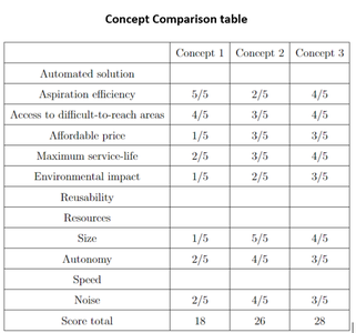

Comparison of the concepts
In the concept comparison table, the fulfillment of the required features is evaluated, and concept 3 is the winner.

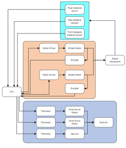

BLOCK DIAGRAM:
The Block diagram

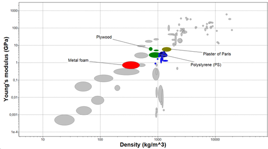

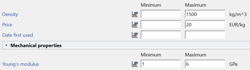

Material selection:
The materials need to be relatively solid to resist impacts and constraints while not being too heavy for performance and safety reasons or too expensive. In order to fulfill those requirements, the following model was implemented in Granta Edupack to find a law constraining the materials to between 1 and 5 GPa with a density and price limit.
The result gives us wood as the hardest material in our selection and plastics as well as metal foam on the softer end. Metal foam being harder to control in terms of shape, wood and plastic are retained. The different pieces of the hoover will be connected to the bottom plate with 3D-printed holders, and the curvy side plates will also be printed. This means those will be PLA, while the rest of the body and the container will be made with MDF and shaped with a laser cutter.
In contrast with the market's hoovers, where they use plastic for nearly all the parts, including the casing, the use of wood allows for easier implementation in the prototype while also making it more resistant in case of accidents during the testing.

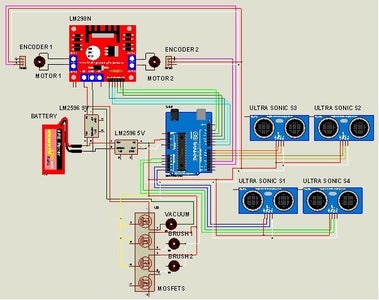

Circuitry and Sensors
As the robot has to include its own power source but has to power multiple voltage devices, two buck converters (LM2596) were used. The first one reduces the battery voltage to 5V to power the Arduino, sensors, and small brush motors; the second one reduces the voltage to 9V to power the vacuum motor and the wheel motors. A button was included on the top of the robot so the user could turn it on or off.

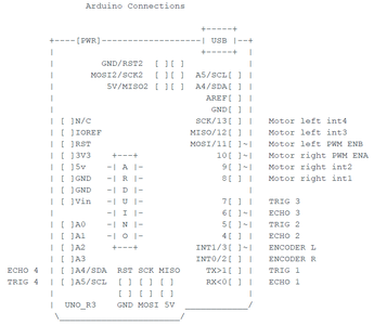

The Arduino connections are shown in the ASCII art Arduino diagram. Since Arduino, some Arduino pins have special operation modes required for this project. Those pins were assigned first:
Interruption pins: pins 2 and 3 on the Arduino board support interruptions. So these were assigned to get the pulse lecture of the encoders every time the motor rotates 0.1 PI.
PWM pins: to control the speed of the motor, a pulse-wide modulation is required. Pins 10 and 11 are selected.
The other connections to the motor driver LM298N (in1, in2, in3, in4) and ultrasonic sensors (trig #, echo #) are selected to keep order.
Software
The software shown in the above flow diagram should enable the product to process the sensor signals to detect obstacles and avoid them with a change of behavior in the actuators. When avoiding one of them, the code should provide a rotating motion when such an obstacle is met so that the robot follows a random cleaning path in the room. Otherwise, the robot should go forward and keep checking the sensors without trying to regulate in a straight line, as the goal here isn't to follow a track but to clean.
Sensors on each side, encoders, an Arduino, and a motor driver are the components in use. When rotating and thus regulating, to determine the position of the wheels, the rising edge of the optical encoder triggers an interruption function in the Arduino code that adds up the number of times the motor rotates by 18 degrees, which corresponds to a 0.45 degree rotation of the wheels. Based on this, the distance traveled at time t can be computed.
The closed loop itself uses the difference between each position to be attained at time t and the one that was attained at time t, as the flow diagram explains. A proportional controller with K was found on the basis of experiments, and the control ends when the total length covered is sufficiently close to the one that corresponds to that of the actual rotation's circumference.
//                  +----[PWR]-------------------| USB |--+
//                  |         GND/RST2  [ ][ ]            |
//                  |       MOSI2/SCK2  [ ][ ]  A5/SCL[ ] |
//                  |          5V/MISO2 [ ][ ]  A4/SDA[ ] |
//                  |                             AREF[ ] |
//                  |                              GND[ ] |
//                  | [ ]N/C                    SCK/13[ ] |   Motor left int4
//                  | [ ]IOREF                 MISO/12[ ] |   Motor left int3
//                  | [ ]RST                   MOSI/11[ ]~|   Motor left PWM ENB
//                  | [ ]3V3    +---+               10[ ]~|   Motor right PWM ENA
//                  | [ ]5v    -| A |-               9[ ]~|   Motor right int2
//                  | [ ]GND   -| R |-               8[ ] |   Motor right int1
//                  | [ ]GND   -| D |-                    |
//                  | [ ]Vin   -| U |-               7[ ] |   TRIG 3
//                  |          -| I |-               6[ ]~|   ECHO 3
//                  | [ ]A0    -| N |-               5[ ]~|   TRIG 2
//                  | [ ]A1    -| O |-               4[ ] |   ECHO 2
//                  | [ ]A2     +---+           INT1/3[ ]~|   ENCODER L
// cleanning syst   | [ ]A3                     INT0/2[ ] |   ENCODER R
//          ECHO 4  | [ ]A4/SDA  RST SCK MISO     TX>1[ ] |   TRIG 1
//          TRIG 4  | [ ]A5/SCL  [ ] [ ] [ ]      RX<0[ ] |   ECHO 1
//                  |  UNO_R3    GND MOSI 5V  ____________/
//                   \_______________________/
