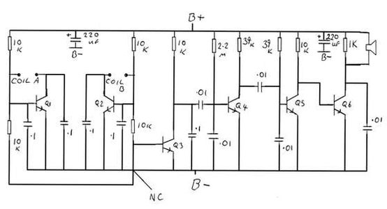

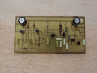

Step 1: Build the Circuit Board
When i was looking in the internet for a metal detector circuit, I saw a couple of desing but they where not specific enough to go into detail and i figured a average person with no knowledge of electronics cant figure it out, so after much joining the dots i finally made one and decided to share it here. all the circuit design is from the link provided "easytreasure". The pictures of my device are mine.

The circuit board is the heart of the detector. There are 2 different styles out there for the home made version. I based my design on this circuit shown here. I build it to the same layout of the circuit, but not necessarily of the print out supplied. in other words, is the same circuit but looks different from the paper. The circuit I copied from this page. I did not design this circuit:
http://www.easytreasure.co.uk/bfo.htm
And it really easy. the parts can all be found on Radioshack for about 10$ total or ordered on the web for about 1.50$ total+shipping. Beware that I emptied the Radioshack out of capacitors and actually had to go to another Radioshack to find the missing one's.
here's a part list:
Power source:
Any 9v battery PP3 is ideal. Remember to also buy a 9V connector for your battery
Capacitors:
2 off 220uF 16v electrolytic.
5 off .01uF polyester.
5 off .1uF polyester.
Resistors:
All resistors 1/4 watt 5%
6 off 10k
1 off 1K
1 off 2.2m ===== 2.2 Mega ohm
2 off 39k
The resistors can be 1/8 of a watt if you use 9V because according to my calculations the highest wattage going through the smallest resistor in the circuit is about .080 watts, and the 1/8 handle up to .125 watt. Radio Shack did had most of them but there was some that where hard to find. so you can either buy some and add the values up to the desired value, or buy bigger and use the Resistance division formula (Total R= 1/r1 +1/r2 + etc). I bought a small bag of 1/8 watt resistors that comes with like 120 resistors from all ranges possible to mankind (maybe not that much) but it had all necessary and now I got a big inventory of surplus resistors. it was the most expensive at 12$.
The transistors are npn. Radio Shack had this small package that comes with 15 NPN resistors for multipurpose general use, and they work fine. You can make 2 circuits and still have some to spare to in case you mess up and need more. Its about 2.50$ for the package.
You can also buy a PCB board to make the circuit and soldering iron (10-15$) 25 watt will do and soldering thin. You can use the cheap stuff for this, don't buy the silver one, too expensive, no difference in this project.
When you're there, get the cable for the coils. You will need about 4 FT of small 22 gauge DUAL wire (that is two wires joined, else you need 8 ft) and some 26 gauge for the coils or whatever you wana use. I bought a small bag that had 3 rolls of insulated enamel wire, 30, 26 and 22 AWG.
The following information, references and quotes are from the Designer website
Coil A = Search coil: Coil B = Reference coil: NC = No connection: B+ = Battery + 9V PP3 or similar : B- = battery -
Notes for the electronics beginner.
2 off 220uf / 16v Electrolytic : These are 220 microfarad / 16v working voltage. You can use a higher working voltage but not less. Higher working voltage capacitors work just the same but they get physically bigger. They have a negative lead that must be connected to the battery - track. These components must go in the correct way round.
5 off .1 and .01 polyester : These also have a working voltage. 63 volt in quite common and will be ideal. If you want to use the pcb layout above you will need capacitors with 5mm lead spacing. .1 can be marked as .1 or 100n or sometimes 104 : .01 can be marked as .01 or 10n or sometimes 103. These components can go in any way round.
All resistors 1/4 watt 5%: These are general purpose carbon film resistors with a 5% tolerance and rated at 1/4 watt. You could use resistors of a higher wattage as this does not affect the working they just get bigger. 1 watt or bigger will not fit on the board. These components can go in any way round.
Transistors: The bc 184b transistor is described has Audio, low current, general purpose NPN . These are quite easy to get in the UK but may be difficult to get in other countries. There are hundreds of types of small plastic NPN transistors available around the world and just about all will work in this circuit. You will have to be sure of the pinouts though. You can get the pinouts for most transistors from manufacturers websites. This will be the most likely problem area when building this project. These components must be connected correctly. PNP types won't work.
I used a Car hands free headset to canibalize the speaker to use for this circuit.
