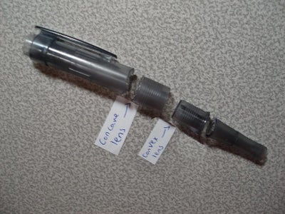

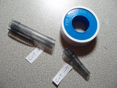

Step 3: Step 2 & 3---Heating and Cutting
Step2: Heat up a knife until it's red, make sure the knife's handle isn't metal, if it is, make sure to wear gloves.
Step3: Look at pictures below to see where to cut, leave some extra space for the larger tube.
If your stuck at this step, feel free to PM me.

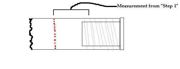

Step 4: Step 4---Perfecting Steps 2 & 3
Step4: Cut off/file down the pieces until you think the lens will fit (screw the 2 pieces together and look at your measurements from Step1, look at Diagram1 and file down to about 1-3mm behind the dotted red line, DON'T GO PAST IT!!)

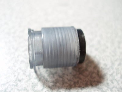

Step 5: Step 5---Putting Together
Step5: Mix a small amount of Epoxy glue, and use a toothpick to apply it to where you put the lens, look at the pictures below for a more detailed description.
Posted by Laser Community member: Vic

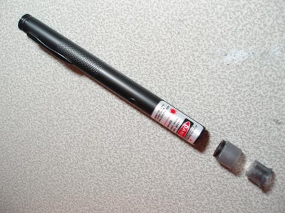

Step 7: Step 7---Attatching to Laser
Step7: Use tape to stick it in front of your laser
For more questions please PM me.
