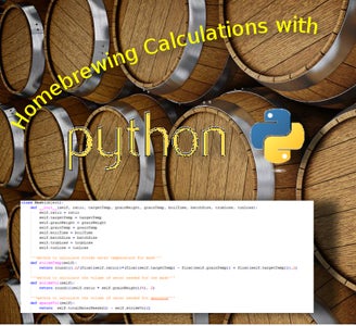

Introduction: Homebrewing Calculations Using Python!
I am an avid home brewer and Python programming enthusiast so I created a simple Python script to help me make my brew day calculations. The script will calculate many useful variables such as strike water temp, strike water volume, and absorption to name a few. You will need Python installed on your computer to be able to run this script. I am not writing this to show how to use Python so I am expecting you have enough knowledge to install Python and run a Python script. I use Python 2.7.8. I also write/run my scripts from Notepad++ using the PyNPP plugin because I hate using IDLE. All of the formulas were adapted from the documentation on the Brew365 website.

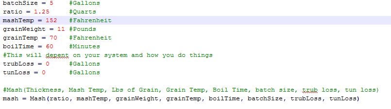

You can create a Mash object by the following as seen in the script:
batchSize = 5
ratio = 1.25
mashTemp = 152
grainWeight = 11
grainTemp = 70
boilTime = 60
trubLoss = 0
tunLoss = 0
mash = Mash(ratio, mashTemp, grainWeight, grainTemp, boilTime, batchSize, trubLoss, tunLoss)
Now you can access the different methods within the mash object.

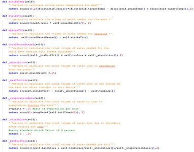

Step 2: Methods
After creating your Mash object you can access different variables using the following methods:
strikeTemp() - returns the temp your strike water will need to be in Fahrenheit
strikeVol() - returns the volume of water in gallons that you need for the strike
spargeVol() - retruns the volume in gallons needed for your sparge water
totalWaterNeeded() - returns the total volume of water needed for your brew day.
There are other private methods that can be accessed that are used in the calculations:
_absorbtion() - returns the total volume of water lost to absorption by the grain in gallons
_mashTunLoss() - returns the total volume of water lost in the bottom of the mash tun after transfer to boil kettle in gallons.
_evaporationRate() - returns the total volume of water to lost to evaporation during the boil. the default evaporation rate is set to 10% (0.10) per hour
_shrinkLoss() - returns the total volume of water lost due to shrinking after cooling the wort. it is set to 4%.
_preBoilVol() - returns the volume of water that should be in your boil kettle after sparging and before boil

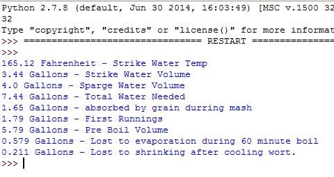

Step 3: Results
If you run my code with the default parameters below line 70 in the attached script it will return some variables and descriptions to the console which will look like the above screenshots depending if you run from IDLE or Terminal. I have attached the script to this Instructable for anyone's use or adaptation. Happy brewing and programming!
