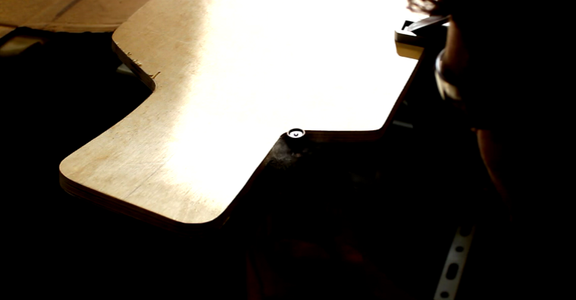

Step 4: Cutting, Sanding, Routing and Drilling.
Cutting out the shape: After obtaining the template sheet from earlier, there are two ways to have your shape be placed onto the plies to begin cutting.
  1. Trace: Cut out the shape to as close to the outline as possible, then tape the outline on the board and trace the general shape. It is better to have it initially bigger than to cut too much off.
  2. Tape Placement: Using clear tape, wrap the sheet onto the plies, aligning the top of the sheet 1 inch away from the edge of the board on each side along with a margin on the sides.
Once the shape is somehow on your plies, clamp down the plies to a secure bench or table and begin to cut the shape out. Following the line, it is recommended to stay a half inch away for sanding later.
Take out scuffs: Use wood putty to fill in any holes or imperfections if they occur after cutting.
Sanding the board:
Once the shape is cut out, sand the extra space away with a belt sander. A Dremel can be used for the curves in the board along with a palm sander for the surfaces. For the edge of the board, I used a trick by CashedOutBoards to have an even edge by cutting a PVC pipe in half and placing 600 grit sand paper in the center. For the wheel wells, I used a pencil case to wrap sandpaper around for the even sanding on edges. Then, using a palm sander at 120 grit for the surfaces followed by a 400 hand sanded and finally a 600 for a ready-to-stain smooth.
CashedOutBoards Process
Routing the edges:
Using a router, I gave the edge a clean look and a smooth transition. I only routed the bottom of the board, however, you can rout each side.
Drilling for trucks:
Drilling holes for the trucks takes patience, you must line up the truck template symmetrically down the middle of the board along with having the trucks an equal distance from each edge. Use a pair of trucks that will go on this board or using the template in the photo, mark each hole and use a 13/32 drill bit, this bit should fit the hardware, but test this out first on scrap wood. After this use a 3/8 countersink bit to have the hardware sit flushwith the board.Do not use the template in the photo, it is only for a reference. To find one search "Longboard truck template" and print off, beware, measure the distance of the paper to check if the lengths are true 2" and 2.25".
