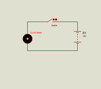

Step 7: Wiring
Connect the wires as shown in the wiring diagram
