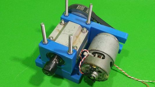

I really like to make things at home using machines, i need a Spindle but industrial machines are expensive so I make them all at home. I make spindle by my 3D Printer and ER 11,775 motor 12v DC
More and More DIY Projects here
Step 1: DIY Spindle
Material DIY ER 11 Spindle with 775 motor 12v DC:
DC 12V Motor 775 double Ball Bearing Large Torque Low Noise.
Collet Chuck Holder ER11 Collet 100 mm Extension Straight Shank Extension rod.
1 Aluminum XL 40 Teeth 12 mm Bore Synchronous Wheel for 11mm Width.
XL-Timing Belt 70XL Rubber Drive Belt Width 10 mm 70 teeth
More all materials take from 3d Printer Machine.
