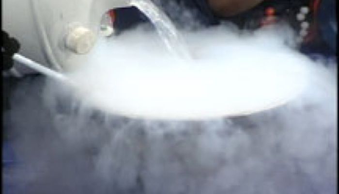

Did you ever think you could make liquid nitrogen in your own garage? This is an industrial process so how can an individual do this? Still doubt me? Intrigued? Read on.
As a lover of science I tried to think of a challenging project that was out of the ordinary. After going through the internet web and Youtube I realized that no one had made liquid nitrogen in his home. Yes, I did see some videos where some would use a Stirling Cooler from a cryorefrigerator and use this to condense nitrogen on the exterior of the cold-head. While one is making liquified gas, this is done using a prefabricated machine. I wanted to make the machine that liquefies the gas. Furthermore, a cryocooler has a very low production rate. You will only get about 500 - 1000ml per day. On the following pages I will walk you through the basics of how to build your own liquid nitrogen generator. Using easily obtained materials you can liquefy nitrogen or air. The unit cools to -320F in under 50 minutes. The production rate is about 350 cc/hr.
A full tutorial and plans are at http://homemadeliquidnitrogen.com This page goes over theory, thermodynamics and more detail on where to get components and how to build this. This Instructable serves as a general introduction to how this baby is put together.
I have just added a new web tutorial on how to make your own N2 gas from the air. I will add this as a new Instructable in the next few days. You can get a link for it at the end of this one.
I have also built a high-precision cryogenic digital LCD thermometer for this project, which you can buy for yourself. You can see how it compares with an Omega digital thermometer here.
Ok. The video above gives you a quick 3 minute overview of the project. At the end of this tutorial I briefly mention the PSA I made for making the pure N2 from the air for the generator. If you're ready for 320 degrees below zero we can begin...

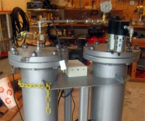

Step 4: The Scrubber
You can make this components out of PVC pipe. I used 4" PCV. You need to get the correct fittings to get to a pipe size that you can then attach to your compressor. The scrubber uses a material called zeolite, or molecular sieve. I specifically used 13x molecular sieve and added some 4A sieve material that had a color indicator added so I know when it has reached saturation. You determine the size of the scrubber based on your flow rate. If you want 3-4 SCFM then you need about 10-15lbs of the material and size the scrubber based on this.
Zeolite is a naturally occurring, finely porous material. By fine I mean the holes are only angstroms in size. Molecular sieve is man-made, but the structure is the same. CO2 and water enter and bind within the pores, letting the other gases, like O2 and N2, to pass through. The color-indicator will change from light blue to gray when the material can not adsorb any more water. One regenerates the material by heating to 350F, driving off the CO2 and water.
Now, back to the device. I cut a disc of 200 micron screening. This holds the 10 lbs of material in place so it does not get sucked into the compressor, but still allows for air-flow. I glued this material between the 4-to-2 inch reducer and the coupler fitting. We need to filter smaller material, so I took 11 MERV air-conditional filter material and cut it into a large circular disc. This should filter 1-3um particles. If you can get a 12 MERV this is better. I fashioned a circular ring of stainless steel that I got at a hardware store and fixed the filter material on top of the 200um screening. Then, poured in 10 lbs of 13x and 4A sieve. I then made another filter disc out of the air-conditioning material and fixed it on the top with a stainless steel ring. This keeps the material clean. You don't want particles clogging the sieve's pores.
The top of the scrubber needs three inputs. One is to allow for fresh gas input. The other connects to the regenerated gas. This is gas from the cooling tower that did not liquefy. The gas is already cool, free of CO2 and water, and in my case is 98.5% nitrogen. I don't want to waste this gas to the atmosphere so I reuse it, reducing the amount of fresh N2 that I need to make. This is why it is called regenerated gas because it comes from the original gas I fed into the tower. The third input allows any excess gas to vent out.
The only other connection is at the bottom where you connect the scrubber to the compressor. I placed a 10um vacuum water trap between the scrubber and the compressor. This will remove particles that can fowl up the compressor, and also serve as a check that no water gets into the cylinders. I also used this spot as a place to insert a gas-analysis meter that I made to monitor the purity of the N2.
You will need to buy a pipe/tube bender to make the coils and rings. I've shown a picture of one above. Mine is meant to bend 1/4" tubing/rod.
