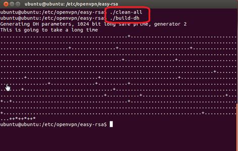

This next set of scripts is going to create the script for the server and one client. In terminal, use the cd command to move into the proper directory by entering:
cd /etc/openvpn/easy-rsa/
Open the source script:
source vars
Clean the directory:
./clean-all
Build the encryption of the certificates and build the actual certificates:
./build-dh
./pkitool --initca
./pkitool --server server

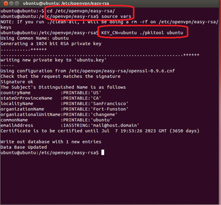

Step 6: Create Client Certificates
The client certificates allow a client device access to the VPN server. These certificates will be made on the server and transferred to the client PC. Open a terminal and enter:
Then prepare the vars script:
source vars
Create the client certificates:
KEY_CN=client ./pkitool client
Replace the word client with whatever name you are assigning to the client device. In my example, I assign the name ubuntu to my client device. Be sure to change both instances of the word client to your specific client name.
Transfer the following files from the server to the client device. If Ubuntu does not let you copy the files. Try pressing Alt+f2 and entering gksudo +nautilus. Then you will be copying the files as root.
/etc/openvpn/ca.crt
/etc/openvpn/ta.key
/etc/openvpn/easy-rsa/keys/client.crt
/etc/openvpn/easy-rsa/keys/client.key
Please note that the first two files have different directories than the last two. Transfer the files to the client device using some form of physical storage. Do not transfer the files over the Internet in a non-secure fashion such as e-mailing them to yourself. Later in this Instructable, I will show you where to place those files on the client device.
