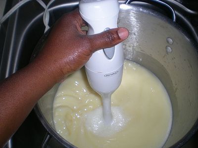

Step 2: Mix, Mix, Mix
Let your lye solution cool down to about 140 deg F, and your oils to about 160deg F, give or take a few degrees.
This step is easier if you have a hand blender. Liquid soap takes a little longer to 'trace' than bar soaps. On average, it takes me about 15 minutes of on and off mixing to get to trace. Be careful not to wear out your blender. Once it starts getting warm, it's time to take a break.
This is what 'trace' looks like in liquid soap (Photo 2). It looks a little like applesauce, kind of thick and slushy. It's when your stock has thickened enough for you to raise your spoon/blender, and trail a 'trace' on the stock.

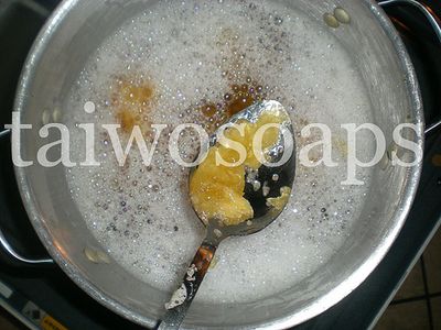

Step 7: After 5 Total Hours of Cooking...
You will usually have a lovely amber colored translucent soap paste. Notice how the soap has bent my spoon while trying to stir.
This is the holy grail of liquid soapmaking, and you have found it! You want this color and translucence, because it means that when you dilute your soap stock with distilled water, it will remain clear, I promise you.
