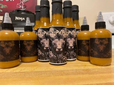

Step 5: Time to Bottle
  • After the pasteurizing is done let your mixture cool. As it cools it will begin to thicken up.
  • Once your mixture is the consistency you desire, carefully pour the mixture in a sanitized bottle.
  • Put a lid on it.
  • Shrink wrap it to make sure it is completely sealed off.
  • Create a unique label to impress your friends. Labels can be made easily on any printer using special label paper. Your local print shop can easily help you with creating great, professional labels.
  • Let it remain sealed for 7 to 14 days for best results. If you're the impatient type, go ahead and enjoy when it’s cool enough.
