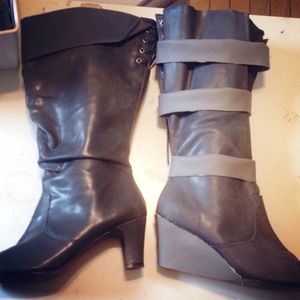

I couldn’t find grey wedge boots – or even booties – for anything less than an arm and a leg. What I did find was a pair of grey, knee-high boots at a thrift store for $8 USD.
- Cons: block heel, slouch style, shiny finish, 1/2 size too big
- Pros: right-ish color, right height, freaking cheap
So I ran with it.

Step 6: Cut the Nylon Webbing Into Six Segments and Attach Them Around the Shaft of Each Boot.
You know what I said about trial and error? Well my first attempt at this part was definitely in error.
I didn’t realize the straps were actually webbing, a detail only visible in the official costuming guide and which was pointed out to me by a very kind member on the Rebel Legion forums. In my ignorance, I used strips of grey vinyl, secured with Shoe Goo, which actually looked fine and, I was told, would be accepted by the RL judges.
Where I goofed was that I measured the straps based on the size of the boot, rather than the size of my leg, so that, when the boots went on, the straps were too tight. Those of you with tiny calves may not be familiar with this problem. Those who also check the “Extended Calf” option when boot shopping will know EXACTLY what I’m talking about.
I wore the boots to work as a test run and, sure enough, one of the straps popped off. (I also realized that I definitely needed insoles and thick socks, but that’s another issue.) Rather than reattaching the not-quite-right strap or cutting new ones, I went ahead and used the webbing, this time using the measure of my calf as a benchmark, instead of the boot.
Using a lighter, I melted the cut ends of the webbing to keep them from unraveling and stitched them to the zipper facing with matching grey thread. I decided to sew them on, rather than return to Shoe Goo, because I think the stitches will hold up better to being pulled on and webbing-to-pleather wouldn’t bond as well as pleather-to-pleather. I also adjusted the position of the straps to cross over the zipper, for the sake of accuracy, and went over the whole boot a few times with fabric paint, trying to get them to a lighter color.
As you can see, I also learned that, unlike vinyl, webbing won’t hold its shape and needs a little help staying in place. I added some extra tacks to the straps to help keep them from sagging.
