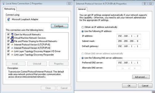

2 - You will now see another Network interface installed in "Network Connections"
3 - Right click > Properties on the Loopback interface.
4 - Select "Internet Protocol Version 4 (TCP/IPv4)", and click the "Properties" button.
5 - Here, you can either set up a static IP or us DHCP that can be provided by your IPCop installation. I chose to use a static IP and picked a subnet that I would not normally use. In my example, I chose the following settings:
IP: 192.168.1.2
Netmask: 255.255.255.0
Gateway: 192.168.1.1 (we will assign this IP to our IpCop "Green" interface)
DNS: 192.168.1.1 (IpCop DNS Relay)

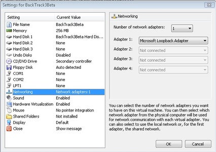

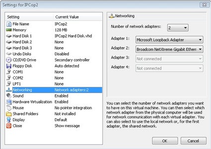

5 - Before starting the virtual machine, you need to configure the network interfaces.
6 - In the Virtual PC Console, Right click on your IpCop VM and choose "Settings". In the "Settings for IpCop" window, select "Networking" on the left side.
7 - Set the number of Network Adaptors to "2". (IMAGE 0)
8 - Assign "Adapter 1" to "Microsoft Loopback Adaptor"
9 - Assign "Adapter 2" to your physical network card. Click "Ok" to save and exit the settings window.

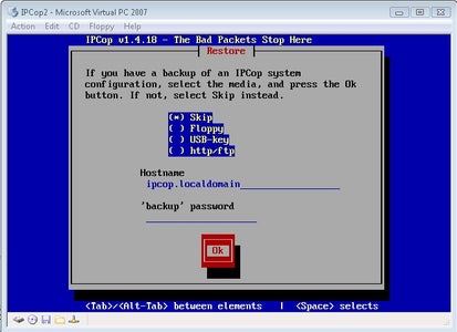

19 - Next, you'll get a prompt asking if you want to restore a backup. We'll choose to "Skip" this section (IMAGE 2)

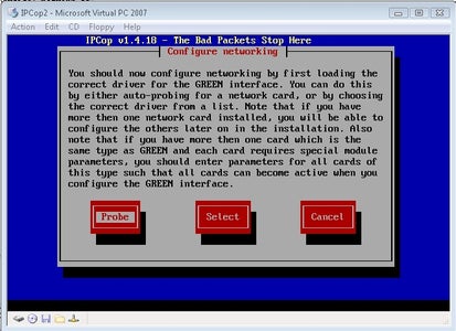

20 - Next, we'll be configuring the "Green" interface. I chose to "Probe" for devices. (IMAGE 3)
21 - IpCop identified the network adapter as "Digital 21x4x Tulip PCI ethernet Card, ect". I then chose "Ok" to continue. (IMAGE 4)

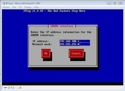

22 - Now, configure IP settings for the "Green" interface. This will be our gateway address we used in step 2.5. Press "Ok" (IMAGE 5)

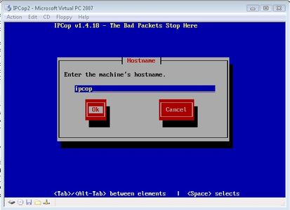

26 - Enter a "Hostname" for your Virtual Machine. Press "Ok" to continue. (IMAGE 7)

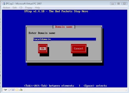

27 - Enter your local domain. Press "Ok" to continue.(IMAGE 8)

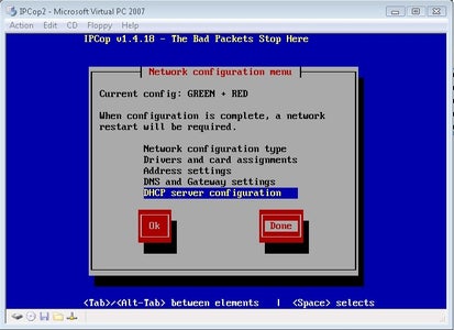

29 - Now, you'll see the "Network Configuration Menu". You'll need to configure all 5 options. (IMAGE 10)
30 - Select "Network Configuration Type" and press Enter. From the next menu, choose "GREEN + RED". Press "Ok" to return to the "Network Configuration Menu". (IMAGE 11)

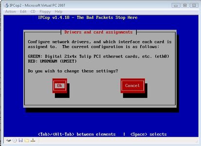

31 - Select "Drivers and card assignments" and press Enter. You will now be prompted to change your current configuration. You'll notice that the "RED" interface is "UKNOWN" at this point. Press "Ok" to change the settings. (IMAGE 12)
32 - You'll be brought to a card assignment screen. Choose "Probe" to auto-detect your network cards. (IMAGE 13)
33 - After Probing, you'll be prompted to assign the second NIC to the "RED" interface. Press "Ok" to continue. (IMAGE 14)
34 - You'll then get a message saying "All cards assigned successfully" and will be returned to the "Network configuration menu".
35 - Continue to "Address Settings" and press Enter.
36 - Select "RED" and press Enter. (You've already setup the "GREEN" interface in Step 3.22)
37 - Enter the configuration documented in Step 1.4 (I'm using DHCP). Press "Ok" to continue. (IMAGE 15)
38 - If both "GREEN" and "RED" interfaces are configured how you want them, press the "Done" button.

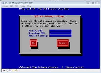

39 - Back at the "Network configuration Menu", Select "DNS and Gateway settings".
40 - If you're using a static IP on your "RED" interface, you will need to enter at least one DNS server IP address and your Default Gateway address here. Press "Ok" to continue. (IMAGE 16)
41 - Back at the "Network Configuration menu" again, select "DHCP server configuration" and press Enter
42 - This configuration screen will allow you to set up a DHCP server to serve addresses on you "GREEN" interface. Since I'm using at static IP on my loopback interface, I do not need to set up DHCP. Press "Ok" to continue. (IMAGE 17)
43 - Back at the "Network configuration menu", press the "Done" button to move forward. (Only proceed if you've completed all of the configuration steps!) (IMAGE 18)

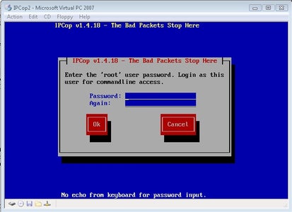

44 - Next, you will be prompted to set a 'root' password for the Linux command line access. (note: when entering the password, there is no visual feedback for how many characters have been entered.) Type a new password twice and press "Ok" to continue.(IMAGE 19)

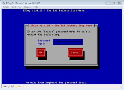

46 - Now, you will set the 'backup' password that's used to export the backup key. Type a new password twice and press "Ok" to continue. (IMAGE 21)

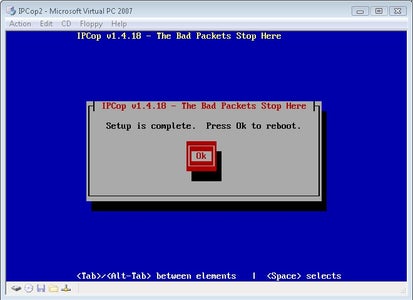

47 - Installation is now complete. Press "Ok" to reboot the Virtual Machine. (IMAGE 22)
