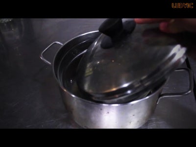

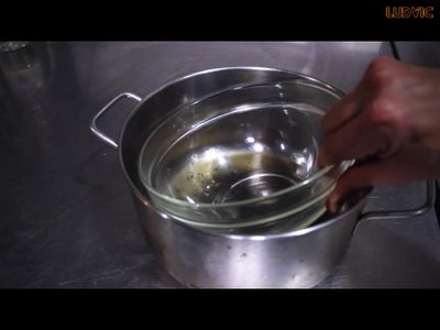

The first thing to do is choose a large pot and a bowl (i prefer glass) to use for the experiment, the bowl should be smaller than pot.

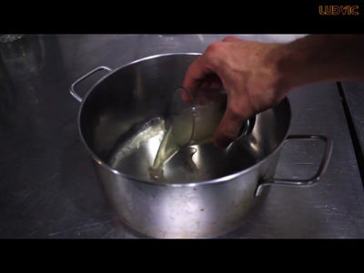

Put your dirty water in the pot, i used water only with ground and sand.
After put the bowl inside the pot like the photo

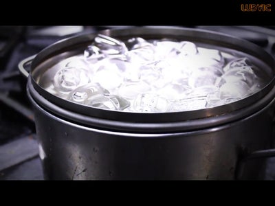

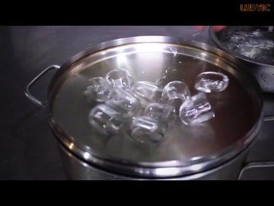

Take the cap of the pot and put in reverse on it. (Look the image)
Now grab some ice and fill the cap.

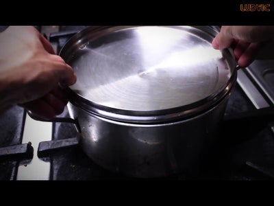

Now put the pot on the source of heat...
This step is really important because you have to replace the ice when it melt...
The fisic phenom is really simple, when the water get hot evaporates (hot) and the steam goes up, the steam flies in the pot and clash with the cap of pot (cold) this difference of temperature condenses the steam, transforms it in the water and drips in the clear bowl...

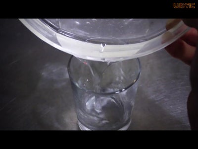

After few time you can open the cap and see 2 thing
1 the clean and distilled water in the bowl
