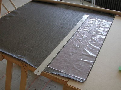

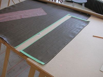

It is easy to pull individual strands of carbon fiber while cutting. Here is an easy fix that will help keep your carbon fiber straight and without annoying pulls in the cloth. This tip will help the finished job look cleaner and more professional.

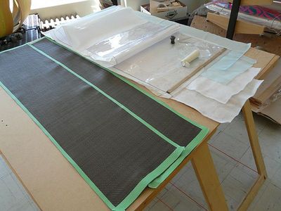

The material has been rolled out flat, on a clean table. You will find that the cloth can twist. Try to make the cloth square before cutting. Use a corner of a table or a builders square as a guide.
Apply masking tape to the areas where you want to cut the carbon. The cloth in the photo below has sewn kevlar on the outside edge. No need to tape over this. Make sure your cut piece of cloth is larger by a couple of inches than the length and width of the decks shape you are laminating it to.
Using a long straight edge and a very sharp utility knife. Cut along the middle of the tape. Make sure you cut all the way through the tape and cloth.
Once cut, the remaining tape holds the carbon cloth from twisting and prevents pulls in the material. Do not remove the tape while laminating.
Now cut your Breather Ply and Release Film to the same size.

All of the materials have been cut in the previous step. This includes:
2 pieces of Carbon Cloth
2 layers of Release Film
2 layers of Breather Ply
You also will want to have your epoxy, Thin Air Press and masking tape on hand ready to use. Making sure everything is ready is a must when working with composites.

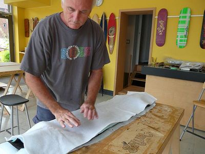

Step 4: Apply the Release Film and Breather Ply
Apply an even coat of epoxy over top of the carbon cloth. Wet it out completely.

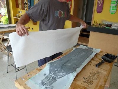

Lay the layer of release film onto the wet carbon cloth. Try to keep it straight as well. Press the material down until it conforms to the shape of the deck. Again, use the roller to get the air bubbles out. Pull any wrinkles straight. It is a good idea to wear rubber gloves (unlike what you see me doing).
Now lay the breather ply down. Pat it down so it conforms to the deck surface.

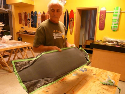

Step 5: Flip and Repeat!
Carefully flip the deck over. Try not to shift the carbon layer on the bottom. Now repeat the same steps on the top of the board:
Apply an even coat of epoxy onto the entire deck.
Lay the second piece of carbon cloth onto the wet deck.
Evenly wet out the carbon cloth with the roller.
Lay the release film down and flatten it to the deck with the roller.
Now do the same with the last layer of breather ply.
Using masking tape, apply pieces around the deck, taping every 6-8 inches as shown. This will hold the loose material together when putting it in the TAP bag.

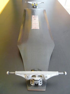

Step 7: Removing Excess Material
You will need to peel away the release film and breather ply after removing your project from the TAP bag. This will take a fair amount of pulling, and sometimes cutting along the edge of the deck.
Once you have the release film and breather ply removed, it is time to clean up the edges of the deck. A sharp utility knife works great. The epoxy/carbon cloth it is very sharp. Be careful!
Trim as close to the edge of the deck as possible. Using a file or coarse sandpaper with a sanding block, remove the remaining carbon to the edge of the deck.
Once you are satisfied with the edge, you can apply any protective coating or graphics you may want. This is about all you need to know about the basics of laminating carbon fiber to a deck! Most of the work is in cutting the material and getting everything prepped.
