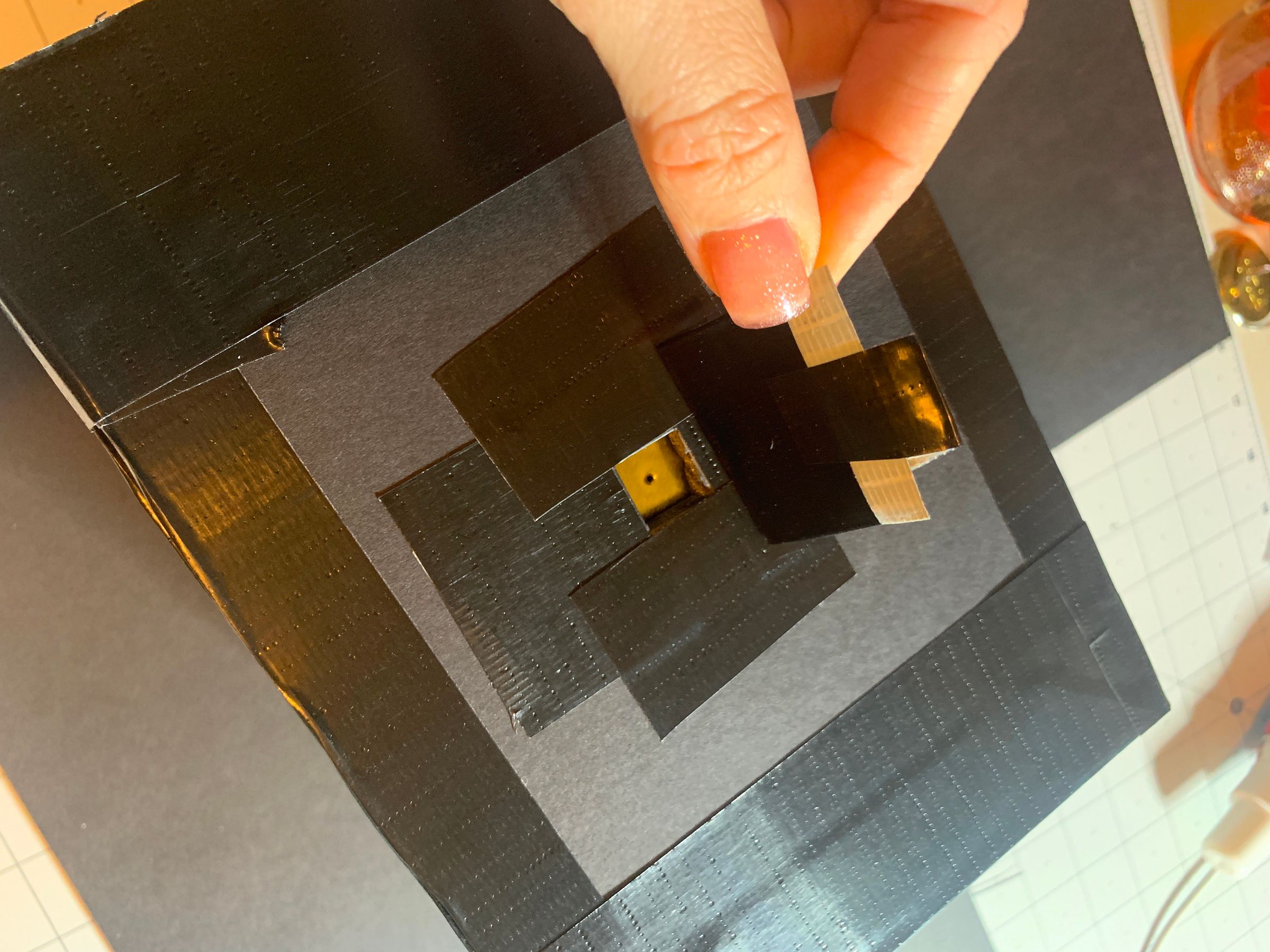

Tape the pinhole behind the square opening. I use electrical tape. Center the pinhole in the square. Then make the shutter which is just a flap that covers the pinhole from the outside. It can be made from some more tape.
