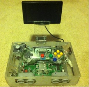

(picture above) This is my first portable.

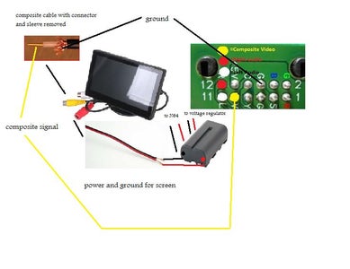

Step 4: Wiring - the Screen
The screen is obviously the display, which is normally your TV, however since were making a portable we need to find a more compact screen.
If your using a ps-one screen you can look for a guide on how to wire it for the n64 portable on the web. This step shows you how to wire any other composite input screen such as the one i used, a 4.3" tft lcd screen, there quite commonly found and used for this project. Screens like these require there own power and can commonly run off 7.2v, check the voltage input for your screen to make sure your not overvolting (you could damage your screen like this). so were going to connect the power input of our screen to the battery in parallel with the N64 and voltage regulator from the previous step (check the wiring diagram above). Then you take the video input wire from the screen and remove the sleeve and there should be a barrel of stranded wire (this is ground) surrounding a middle wire (this is the video signal), depending on your screen there could just be two wires or pins that correspond to ground and signal (they should be labeled), take the middle signal wire and solder it to the v (video) pin on the back of the av out port and take ground and solder it to one of the G (Ground) pins, or another ground pin on the board. This is all in the wiring diagram above.
P.S. all connections should be made with solder, and if you want you can cover the connections with glue or insulation to make sure there's no short circuits.

And that's about it for the wiring now test the system to make sure it works and there's no shorts before its placed to the case.
