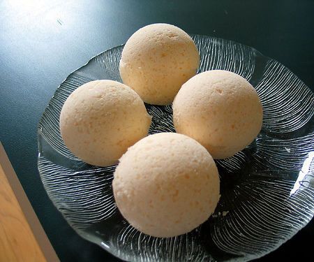

You don't need to leave them in the mold for very long, and in fact can tap them out as soon as you fill them. These are four bombs we made with this batch.

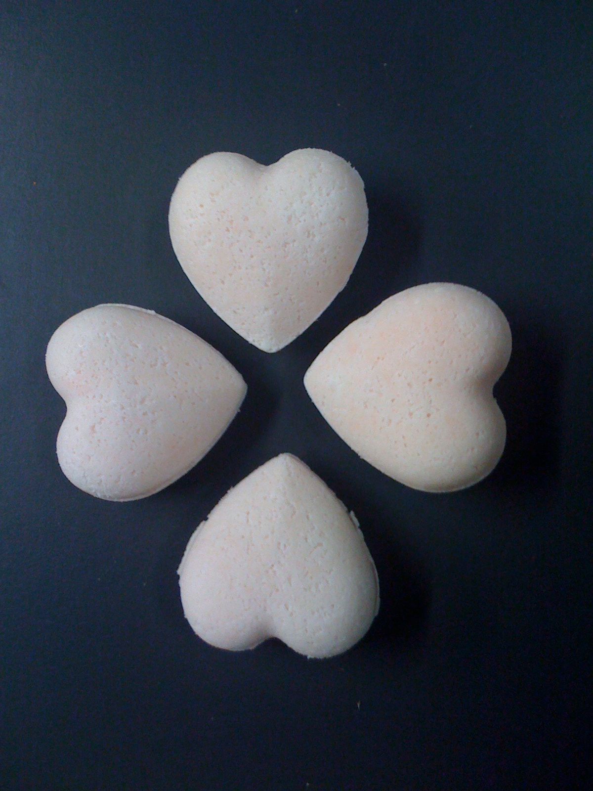

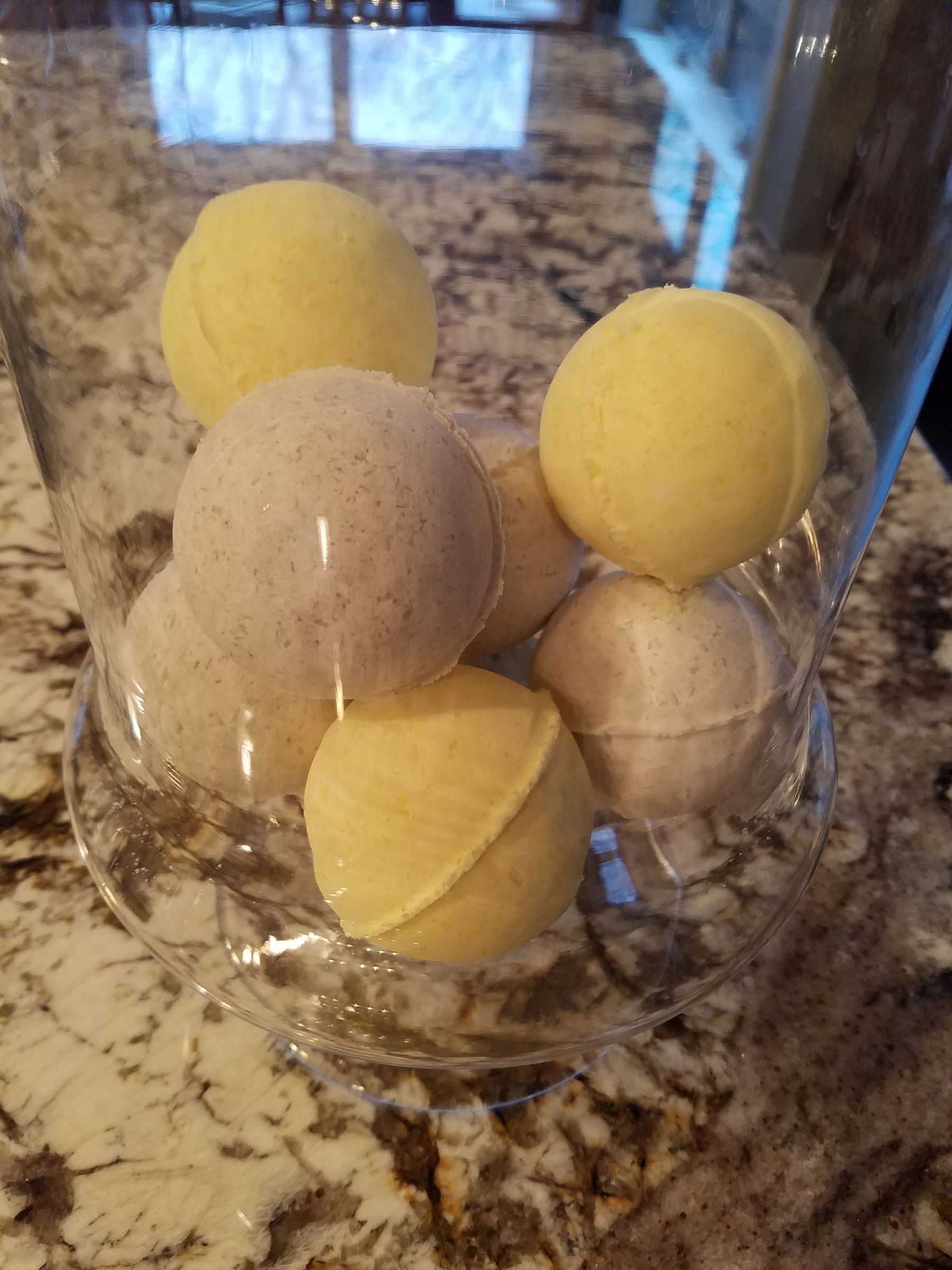

OK, here they are! I bought 4 of these molds and one batch filled them with a little to spare. I started early for Valentine's Day so I had time to screw up a couple of batches, but I think these are going to be fine as. Peppermint. Maybe I'll make one more different batch. What about glycerin instead of oil, would that work? I used almond oil, but I wasn't really happy with it.

FactoryDirectCraft.com I just googled 'fillable plastic hearts' and started clicking. The ones I got are 80 mm (the medium size). In retrospect, they're pretty big, I'd recommend going with the small ones.

Oh my, I am so glad you mentioned that about peppermint! I've been "stung" by Dr. Brommers before, I should have known better. Now I know I have to make another batch with a different oil. One thing I like about these molds is that ice cube trays would make half hearts (they're flat on one side). These are snap-together, two piece molds. They make full 3d hearts, which I think is cool. I thought they might break apart unsnapping or trying to pry them out of these molds. But no problem, they plopped right out.

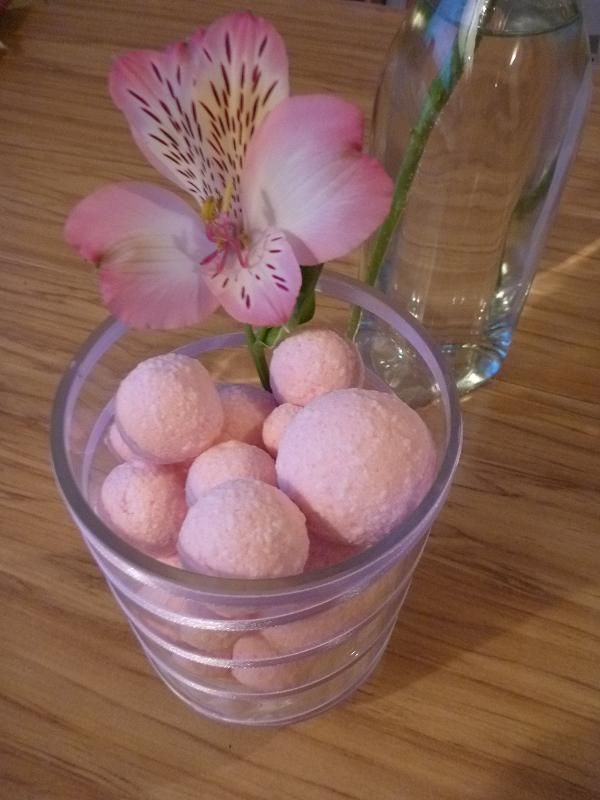

Hey guys, these are great! I made them yesterday and have packaged them up for my girlfriend this morning! Isn't she lucky it was raining yesterday and I couldn't work :P
I used 2 pairs of measuring spoons to form the molds, they worked well once I had the right consistency. I just forced them together to form a sphere. A 1 Tbsp one for the big ones, 1.5tsp for the medium, and 1/4tsp for the tiny ones.
Over here in a country town in New Zealand, its hard to find the right fragrance oils that are safe for skin. I know I could of ordered online, but it was a matter of now or never, So while wondering what I could use to add some scent, I remembered how much my gf liked my CK cologne, so just cracked open my bottle of that, and poured about 2tsp of the stuff in. Didn't like being with the water much, but guess it was similar to oil.
Here's a couple of pics, Hope you like them.
