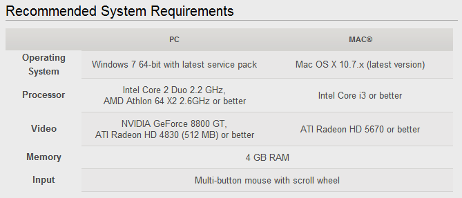

Step 2: What Do Your Games Require of Your Computer?
You can find the requirements needed by your computer to run certain games on the website where you plan to purchase the games, on the physical game's box or pamphlet, or use a resource such as the Can You Run It? website. The simplest and most informative of these options is referring to the resourceful website linked in the previous sentence. After opening the link, you will see the image tagged as "Can You Run It Search." You can type the name of any popular game in the "Search a product by typing its name" textbox, or you can browse the games in the dropdown box below the textbox. After you have decided a game to search for, you select the "CAN YOU RUN IT?" button at the bottom-right of that image. Depending on your browser, it may prompt you to install and run a temporary application that searches your computer for the necessary components needed to run the game(s).

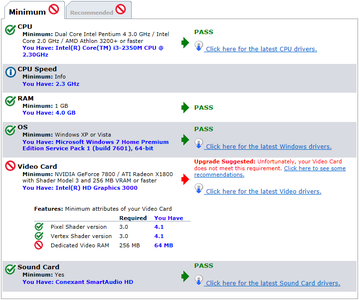

Step 3: What Does Your Computer Need Upgraded to Run the Game?
After running the test from the site, it will display information similar to the "Requirement Comparison" image. This will display the minimum and recommended components the game requires to run. It will also give you upgrade options from in each category listed that the game requires. The upgrade options link sends you to TigerDirect and lists off the possible upgrades and their prices. You should select the links for recommended upgrades and note the upgrade options with its corresponding price. This will help us determine if upgrading our computer is a practical idea later on.

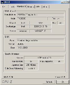

Step 4: Finding Out Your Motherboard Model
Before you can find out what components to buy, you must make sure they are right for your motherboard. Generally the recommended program used to find your system components is CPU-Z. Once you have downloaded, installed, and opened the program you select the "Mainboard" tab and can now see the model number and manufacturer (Shown in the picture tagged as "CPU-Z Mainboard Tab").

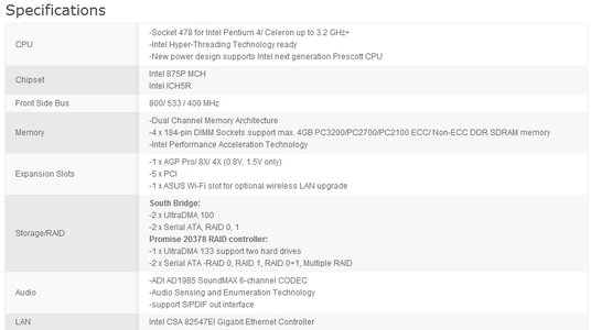

Step 5: Finding Specifications of Your Motherboard
After discovering your motherboard model, you can then search on the internet for your motherboard and look at the specifications to see what speed/type of RAM you can use, what socket your Processor is, what slots you have available for video cards or sound cards, and what connections you have available for hard drives. An example of a limited specs page is tagged as "Specifications Example." If your motherboard does not support any of the options we noted for upgrades in the previous section, upgrading this computer is no longer an option. In most cases, the cost of upgrading the motherboard is more than buying a new computer or gaming console when considering all the new components and amounts of time dedication this requires.
