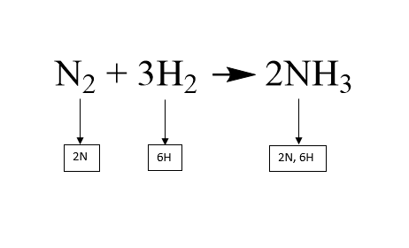

When approaching a chemical equation, it is important that you understand the difference between coefficients and subscripts. The coefficient is placed in front of a molecule, while the subscript follows certain atoms as shown in the first picture.
In a molecule, the coefficient denotes the amount of that molecule present. The subscript of an atom indicates the amount of that atom in the molecule. For example, in the first picture the coefficient for the second term indicates that 3 molecules of H2 are present, and the subscript of the first term signifies that 2 atoms of nitrogen (N) are present per molecule of N2.

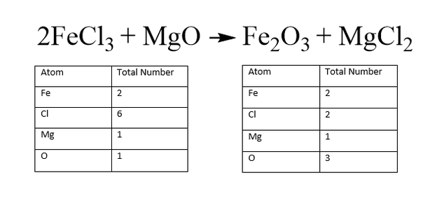

Adding a coefficient in front of a molecule multiplies all atoms within that molecule by the number of the coefficient. If an atom has a subscript, the coefficient and the subscript multiply to yield the total amount of that atom in the molecule. For example, in the second picture, the coefficient for ammonia (NH3) on the products side is 2. The 2 is multiplied by the subscript of hydrogen which is 3, yielding a total number of hydrogen atoms equal to 6.

Step 2: Sum the Atoms
- Create a chart for the reactant and product sides of the equation
- Count the number of atoms for each element on both sides of the equation
- Fill in the charts with the appropriate atom counts

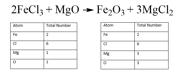

Step 3: Balance the First Element
- Choose an element with which to begin
- Add a coefficient to the start of the molecule containing this element on one side
- Choose a number for the coefficient that would cause the atom count to equal the atom count of that element on the other side of the equation
- Alter the chart based on the change caused by the coefficient
Step 4: Repeat for the Other Elements
- Add coefficients for the other elements as done in step 3
- Alter the chart as the coefficients change the atom counts
- It might be necessary to go through the process more than once as changing a coefficient can alter the atom count for an element that has already been balanced
- Continue until the atom counts for each element on one side is equal to the atom counts on the other side
