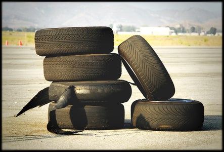

Step 1: Tires
Inflate your tires to, at least, the maximum inflation pressure to reduce rolling resistance.
Should you wish to go beyond, that is up to you. Personally, I inflate my tires to around 55psi (they are rated for 44). Please do not attempt on old or visibly damaged tires. My tires are new and in excellent condition.
Modern tires are radially belted - that is, they won't balloon like tires of yore. Keep in mind what you're doing though. You are reducing the contact patch of your tires in order to decrease static friction. This will reduce your overall braking ability. So riding someone's bumper at 80mph is just that much more dangerous. Again, these steps only work when combined - you can't pick and choose.
When it comes time to buy new tires, look for low rolling resistance (RR) tires. While they may not have the same 60,000 mile (or even 40,000) guarantee, they will save you in the fuel department. The Toyota Prius comes equipped with LRR tires.

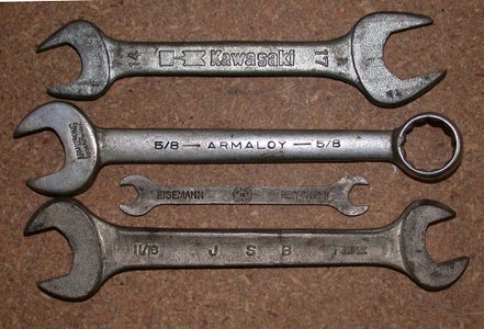

Keep your engine in Tune and use the lightest weight of oil as possible. In addition to friction, you also have to combat viscous forces. The thicker the oil, the more resistance your engine has to overcome.
O2 sensors are very critical pieces of equipment - especially the 1st one (primary).
If you have a check engine light (CEL) and your car is a 1996+ model (for US vehicles) - get your car scanned. Certain auto parts places will scan codes for free (such as Autozone). Fixing parts yourself can save a lot of money - that is, only if you feel comfortable doing it.

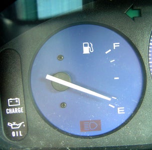

Install a trip computer that can give you instantaneous fuel consumption feedback. Then, turn driving into a game - always try to beat your highest score.
Nissan, according to internal testing, estimates gains in fuel economy ~10%
All New Nissan Vehicles will be equipped with fuel consumption instrumentation.
Toyota Estimates 5-10%, and They too will include instrumentation in new vehicles

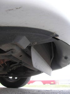

  • Belly Pan - A significant amount of resistance comes from the open areas under your car. Covering them with corroplast or some other material can reduce your drag coefficient (Cd)

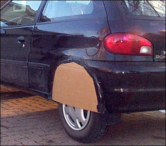

  • Wheel skirts - covering your wheel wells to keep your cars body one contiguous object can help

    just look at the tyre that's on the picture, is like a ballon, overinflated and blown up
