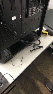

Step 1: Prep the Case
Open the case: Unscrew the black bolts found on the case

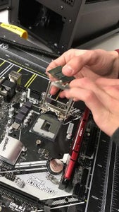

Step 2: Install CPU
  • Take the mother board out and take off the black piece of plastic covering the CPU slot
  • Open the lever and push up
  • Next grab the CPU so the pin side is facing downwards
  • Line up the CPU slot (there are two tinny trinagles one on the CPU one on the bracket line those up), and let it drop into place
  • Next pull down the lever and clip it back into place

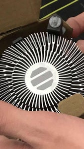

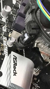

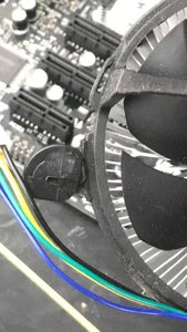

Step 4: Install Heat Sink
  • Grab the heat sink from the sides
  • turn all for nobs till the arrows are pointing outwards
  • carefully line up the notches, now apply pressure to the heat sink
  • finnaly check the back of the mother board for white notches to confirm heat sink has been installed correctly

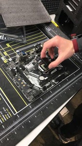

Step 7: Test Componets Outside of Case
  • Now plug your power supply into the walloutlet

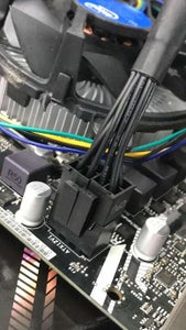

  • Plug the 24 pin into the motherboard from the powersupply
  • Plug the 4/8 pin CPU connector into the mother board
  • And use your screwdriver to hotwire the motherboard inorder for it to turn on
  • now check to make sure every componet is funtioning correctly

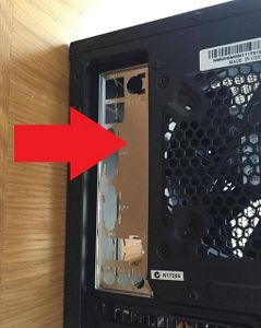

Step 8: IO Sheild
  • Next grab the IO shield and click it in from the inside of the case
  • Apply pressure to the corners until firmly fit in place

  • Next plug in the 24 pin and the 4to8 pin

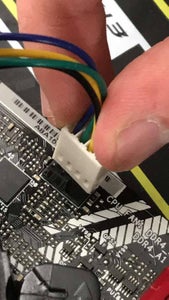

  • And plug in the three pin fan connector

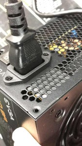

Step 11: Install Power Supply
  • Next install the power supply
  • Again using the cross method to apply equal pressure
  • Finally connect the power cord
  • And turn the switch to on

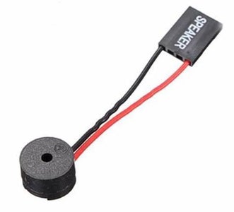

  • Most motherboards come with a speaker installed if yours does you should hear a single beep when you turn on your computer

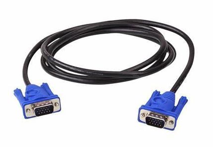

  • if yours doesn't don't worry take a hdmi, or a vga cable and hook it up to a monitor
  • if the montior doesn't output anything it means something isn't working properly
