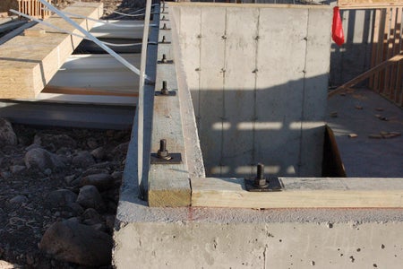

Step 2: Cut, Drill and Attach the Sill Plates
These are the steps to mark and drill the sill plates:
- Place the treated sill plates directly over the chalkline location they will be installed on, rest it on the bolts and then hit the plate with a hammer into the bolts so that the anchor bolts make an indent in the sill plate.
- Roll the plate over and use a 3/4" drill bit to drill a hole where the mark from the bolt is.
- After all the holes are drilled place the sill plate on the bolts and check to make sure it is lined up with the chalk line. Adjust with the drill as necessary until it is perfect.
These sill plates are held back from the edge of the foundation so bricks can be installed.

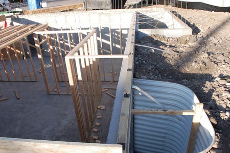

Step 3: Build Basement Bearing Walls - Where Necessary
This is a image of a basement stairwell wall and main bearing wall.
Notice the wood blocks next to each wall stud. Notice how the plate is 1/2" in from the outside of the foundation at the corner but farther away it is flush with the outside of the foundation. This foundation is out of square.

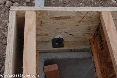

Step 5: Attach the Rim Joists
The rim joist is attached at the ends of the joists to keep the joists
stable in the upright position and to carry the weight of the walls and roof above. The rim joist will typically sit on the edge of the sill plate.
It is common to notch the rim joist over the anchor bolts.

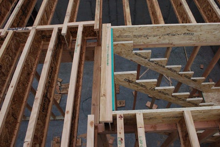

Step 7: Stairway and Balcony Openings Are Framed Using Bearing Walls or Beams Below
If there is a stairway opening you will frame the walls for it just like
you did the main bearing wall. The floor joists will run to the inside of the stairway and be headed off with a rim joist on the inside side of the stairway.
Stairway opening in floor joists. Notice how the rim joist sits on the
inside of the stairwell wall so the floor joists can bear on the wall. The two joists at the top of the stairs provide additional support to hold the stair stringers.

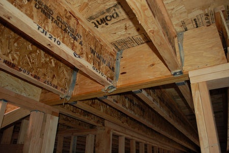

Step 8: Beams in the Floor Require Joist Hangers
Sometimes you may want to have a beam holding the floor but you don't
want the beam to be below the floor joists. This problem can be solved by installing a beam in the floor joist system and hanging the floor joists on the beam. Make sure to use construction adhesive in the seat of the hanger to prevent floor squeaks.
The beam is typically sized to be the same height as the floor joists.

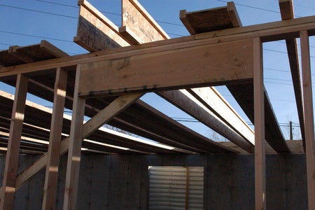

Step 9: Beams Under the Floor Joists Allow the Floor Joists to Go Over
Other times you can simply put the beam under the floor joist. This beam
will get trimmers under each end to hold it up before the framing is finished.

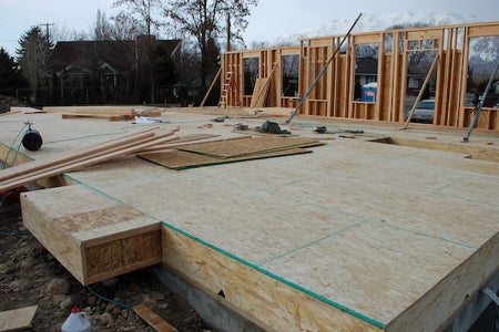

Step 10: Cantilevers Allow the Floor to Be Framed Out Past the Foundation
Cantilevers are used to extend the floor beyond the foundation. This is
popular with fireplaces, breakfast nooks and bay windows. Follow the engineering specifications when determining how far the joists need to extend under the floor to allow your desired cantiliever.

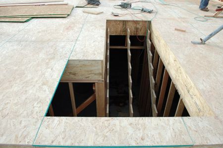

Step 11: Sheeting the Floor With OSB or Plywood
The final step in building a floor for a house is to sheet it with OSB. The OSB or plywood must be staggered like stacking bricks to give it strength. OSB floor sheeting is typically 3/4" thick and comes with a tounge and goove to give the spans between the floor joists strength.
Pick a wall to start installing the floor sheeting from, typically you will start at the same end that you laid out the floor joists from so you can start with a full or half sheet.
This is the floor sheeting around the stairwell. Notice how the rim board and the sheeting and the wall below line up perfectly. Also notice how we left the sheeting over hanging the first step so there will be a stair nosing coming off the floor. Wait until the stairs are in to cut out the sheeting over the bottom part of the stairs to make sure there is the code required 6'-8" of headroom.
