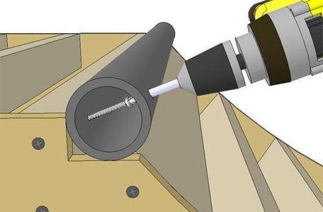

Step 5: Coping
For our coping we used some old scaffold poles we quite literally found lying by the side of the ramp in the undergrowth nearby. We then used the method depicted in the photo to attach it to the top of the ramps.
