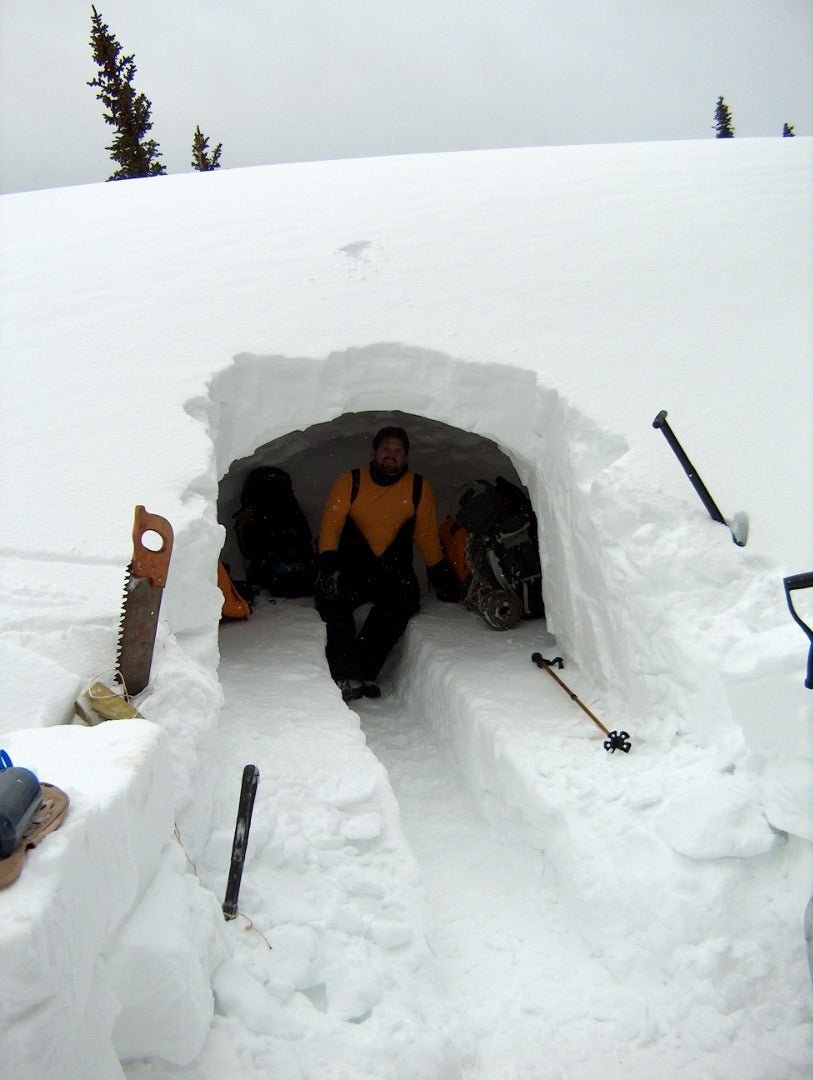

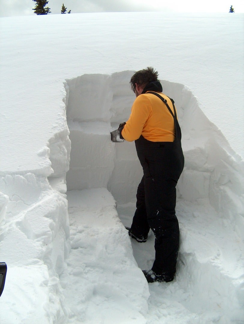

Step 3: Start Digging
We always build our caves on the "back" side of the drift. This is the side away from the oncoming wind. This way, when the wind blows, it doesn't blow into the cave. A light accumulation of new snow is usually easy to manage.
I start by digging a path into the mound until my cut is about as tall as me. Once I get close to where I want my front door to be, I use the hand saw and cut my snow into blocks. I like to make them about 16" each way and as square as possible. Set these aside. They will be used later to build your front wall.
Once you have about 8 or 10 pieces (enough to enclose your front wall), you can go back to using the shovel. The cave will have a mushroom shape. Don't over excavate the floor. You want your sleeping area to be raised to about bench height. This will make being in and moving around in the cave easy. It will also allow the cold air to fall to the floor which needs to have a slight slope down to the outside.
Build a bench wide enough to lay comfortably on both sides and across the back. The sides will be the bed and the back will be your storage / table area. The cave needs to be deep enough so that the side benches are long enough for you to sleep flat on your back plus about 18" for your gear. I like to dig deep enough so that there is enough room for all of this plus the thickness of the front wall and a small bench outside the cave. My total length of bench was about 12 feet. Another small alcove shelf can be built about 12" above this platform. Here you can place a small candle. You would be surprised how much a candle can raise the temperature in a well insulated enclosure like a cave. DO NOT bring in a heater. You don't want to melt your cave from the inside.
Your gear should be kept inside. Searching for and digging your personal gear out of 6" of new snow is not fun.
Build the walls on a slope but tall enough so you can sit upright. The ceiling needs to have a nice arc in it to carry the load of the snow. DO NOT build straight up walls and a flat ceiling. They will not support near as much load and more than likely will collapse.
Use your ski pole (or stick) to make a small (1" to 1 1/2") air hole at the highest point in the ceiling. This hole needs to go straight up, all of the way to the outside and must be maintained while anyone is in the cave. This will let in fresh air and keep heat from accumulating at the top and melting your cave.
Now is a good time to move all of your gear in.
