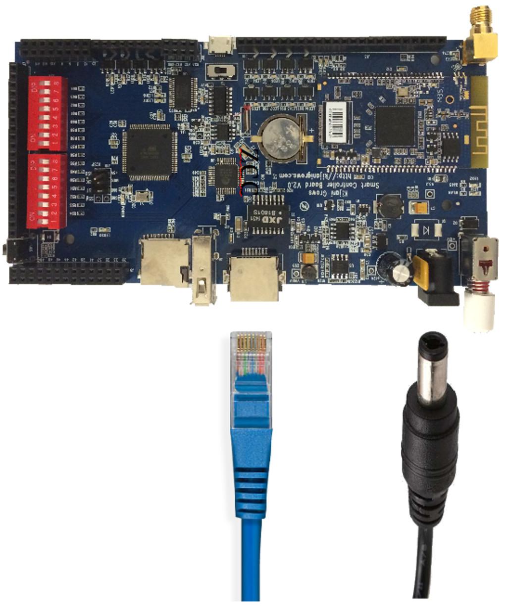

Step 15: Powering the V2 Controller
 Power the v2 controller by depressing the white power button. Your computer will be assigned an ip address 192.168.73.x by the v2 controller if it is DHCP enabled

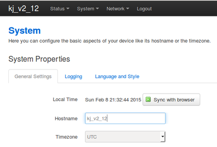

Step 17: Setting a Unique Hostname
On the System menu bar, click on 'System' from the dropdown list. On the System menu bar, click on 'System' from the dropdown list. You can optionally change the default board name and timezone here. Type in the new device name in the 'Hostname field. You can change the Timezone here as well. Click 'Save & Apply'. Depress the power switch Off/On for the new hostname take effect.

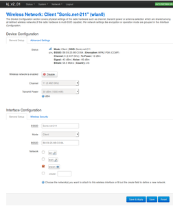

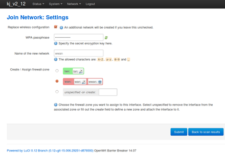

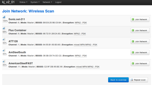

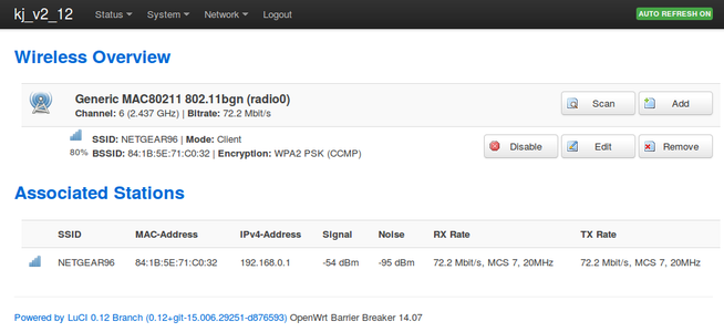

Step 18: Configuring WIFI
While still connected using Ethernet and DHCP. Access the v2 client using the URL   http://192.168.73.1. Select the 'Network' from the menu, then select Wi-Fi from the drop-down list as shown. On the Wi-Fi, menu, click on the 'Scan' button and select your Wi-Fi Network from the list using the 'Join Network' button as shown. Enter the security credentials for your network, click the Submit button. The status wireless icon should turn blue and indicate the strength of the connection. Click on 'Save & Apply' to complete the Wi-Fi configuration. Confirm your Wi-Fi connection using the status menu. From the 'Status' menu, select the 'Overview' option. Ensure you have an IP address In the Network section. Double-check your Wi-Fi Security credentials if the controller did not make a connection in the Wireless Security tab shown above

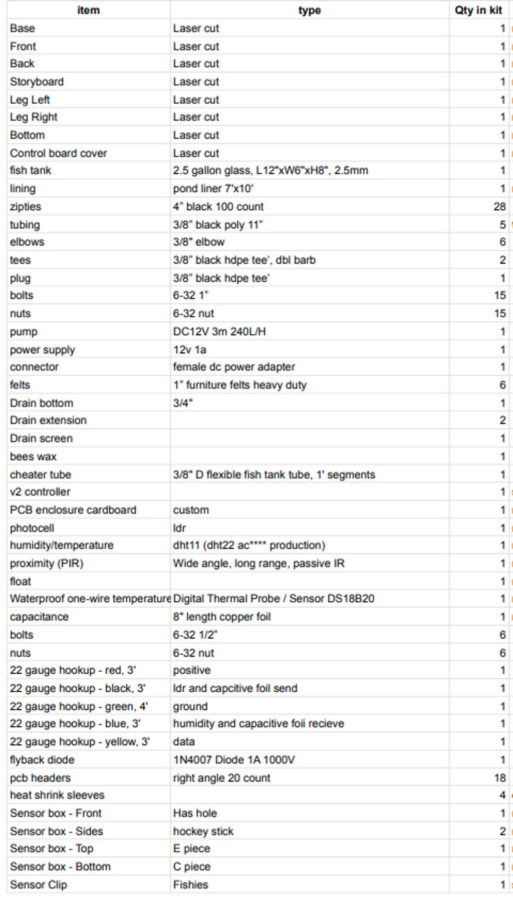

The following are the sensor kit parts:
  • Sensor box
  • Humidity / ambient temperature sensor
  • Proximity sensor
  • Light level sensor
  • Fish tank float level sensor
  • Water temperature sensor
  • Capacitance growbed sensor
  • Wires
  • Heat shrink tubing
  • Screws and bolts

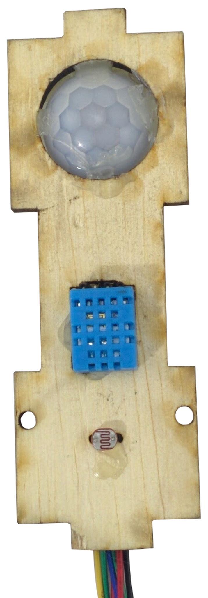

Step 22: Environmental Sensors

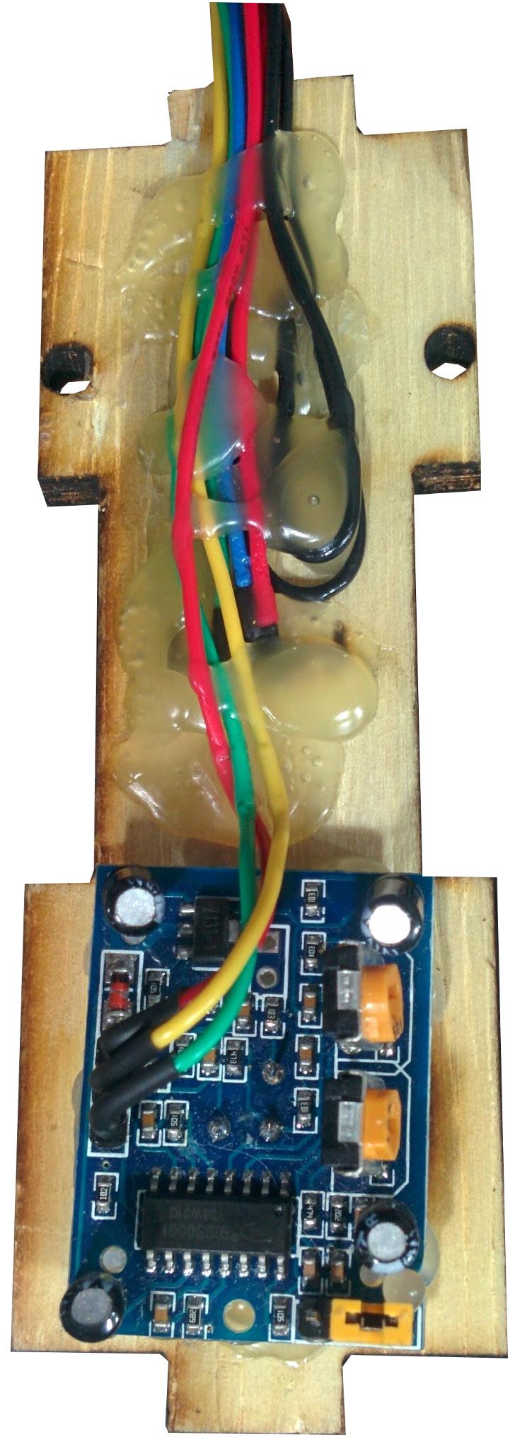

We begin by wiring the sensors that go on the sensor box as shown below with the proximity sensor. Red and Green are always +Vcc and Gnd respectively. The yellow wire is the data line for this sensor. Cut each wire length to about 1.5’. Tin the sensor contacts and stripped wire ends using solder. Solder the wire ends and pins together. Insert the heat shrink tube and shrink this using hot air (eg, a hot air gun, hairdryer etc). Wiring the photocell light sensor.
Wiring the humidity-temperature sensor. Red and Green are always +Vcc and Gnd respectively. The blue wire is the data line for this sensor. After soldering the wires and shrinking the tubes, fold the pins towards the backside gently but firm. Do not unfold the pins after this(or they may break)
The photocell sensor does not have polarity. One end is the data line and the other is goes to Gnd.
Step 23: Assembling the Sensors

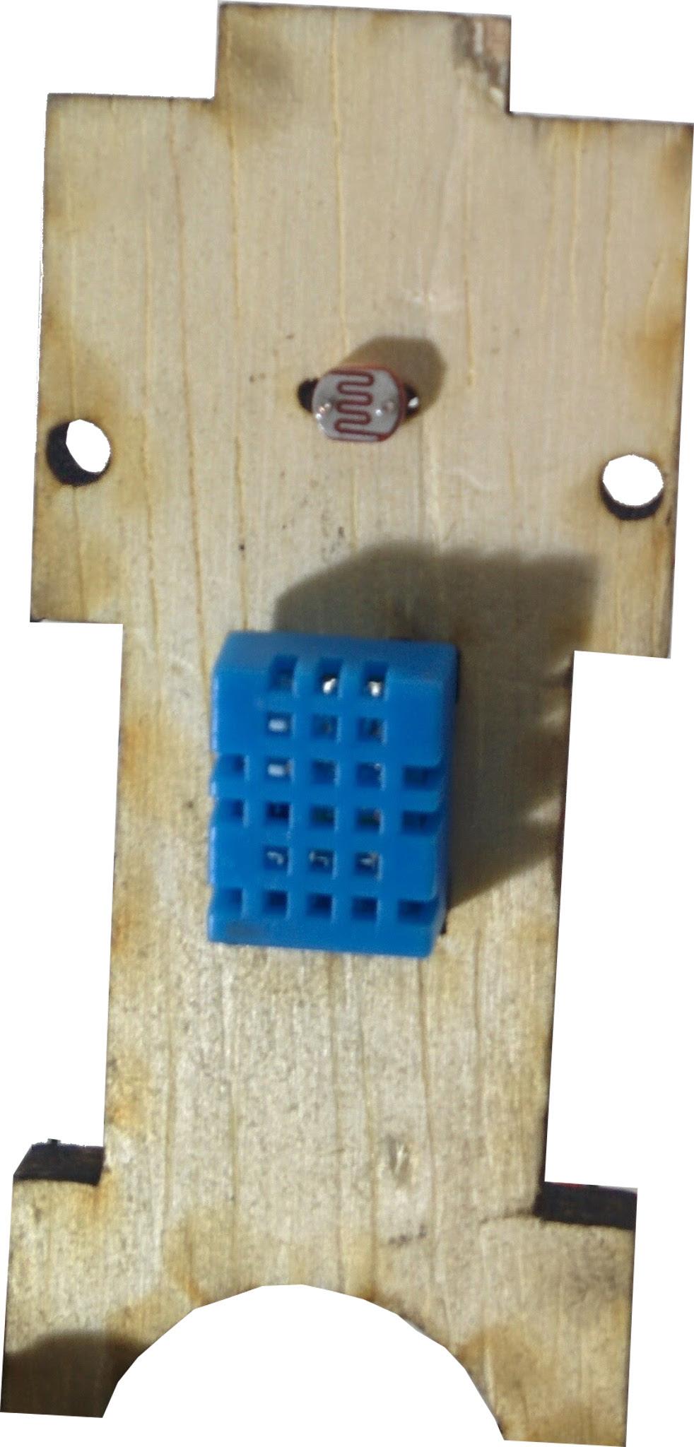

Insert the light sensor and humidity sensor pins through the sensor box as shown.
Insert the proximity sensor from the back as shown. Orient in search a way that the side pieces of the sensor box fit. Ie ..with the wire header on the right of left side when the sensor box is held upright. Tack the proximity corners using hot glue. Try not go glue beyond the sensor width so as not to block the side pieces of the sensor box from closing together.

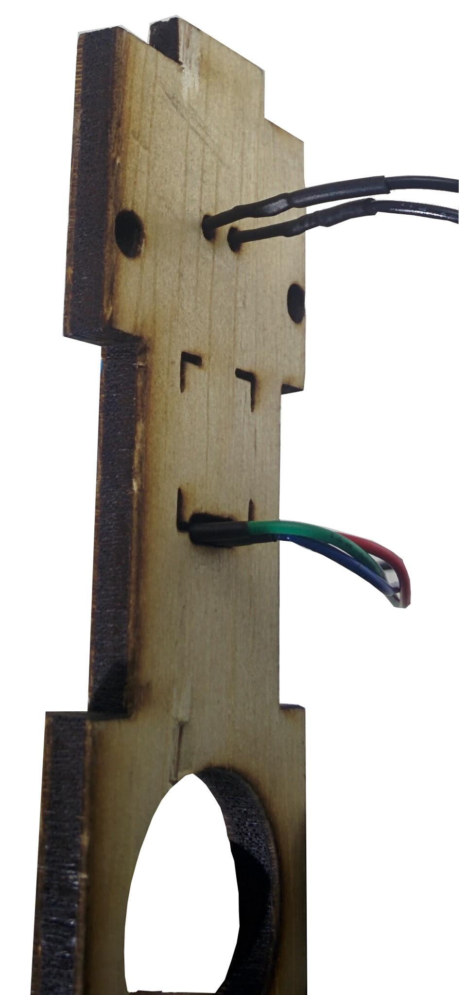

Step 24: Assembling the Sensor Box
Step 25: Wiring the Environmental Sensors
We will now complete the wiring of the sensor box. All the sensors require grounding, where the proximity sensor and the humidity sensor require +Vcc. To simplify wiring we will connect all the sensors to a common power source. We begin by sniping all the ground(green) and +Vcc to a manageable length say 2” long as shown below (do not snip the data lines from each sensor). Strip the power wires and twist the stripped ends together. For the ldr sensor, you can use either wire as ground and the other as data. The ldr is the black wire. Tin the stripped end using a soldering iron and solder, shown. Strip and solder the tips of one of the longer red and green wires that got clipped off from the sensors earlier. Solder and connect the wire with the power wires from the sensor box as shown below (only better, i iron was too hot) Cut out short sections of the heat shrink sleeve, just enough to cover the soldered joints (~1cm) and slip these through the other end of the ground and +Vcc wires as shown. Shrink these using hot air such as from hot air gun or a hair drier to make an electrically and mechanically joint as shown. We address the other ends of the wires from the sensor box by terminating them with pcb header pins as shown below. Insert the heat shrink sleeving before soldering the wire to the pin. After breaking off and shrinking the pcb head, the pin should look as shown below. Repeat for the rest of the sensor data and power wires. The completed sensor box with 3 data and power connections is shown.

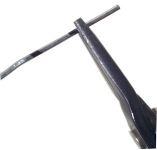

Begin by straightening out the paper clips. Mark one of the paper clips as shown below using a felt pen or sharpie at 1 cm, 2 cm, 6 cm, and 10 cm from one end
Step 30: Tank Level Paper Clip Holder
Fold the wire to create right angles at the 1 cm and 2 cm markings as shown. At the 10 cm mark, snip or break the line by holding with pliers and folding repeatedly. Make a circle from the 10 cm end with a circumference to the 6 cm marking as shown. Fold the loop, so it is perpendicular to the steam, as shown. Run the wires from the float sensor followed by the float sensor stem into the loop we just created as shown. Lock the sensor using the o-ring(for storage if available) and the nut as shown.

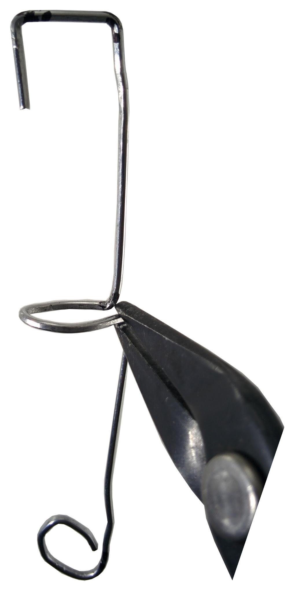

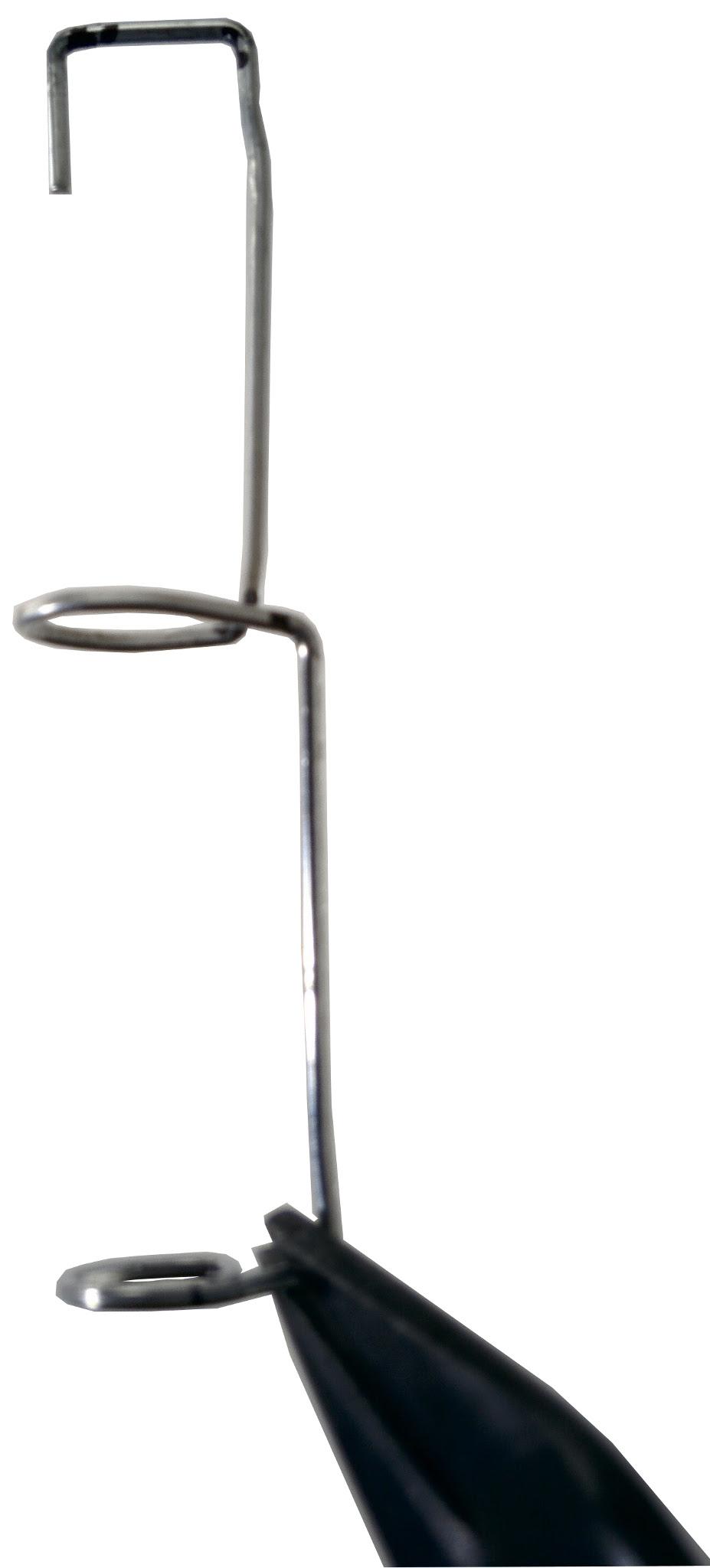

Step 31: Water Temperature Paper Clip Holder
Using your sharpie or felt pen, measure and mark out the second wire at 1 cm, 2 cm, 5.5 cm, 8.5 cm and 12.5 cm as shown
Step 32: Preparing the Paper Clip Temperature Holder
Bend the loop so that it is perpendicular to the right angle folds as shown. Create another loop from the tip of the clip to the 8.5 cm mark as shown. Bend the first loop, so the bottom end is parallel to the right-angled folds. Bend the lower loop until it is parallel to the upper loop, as shown. The wire clip is shown with the temperature sensor inserted
