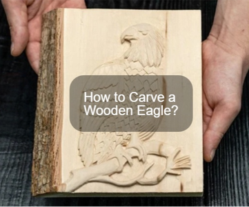

Step 1: Choose the Perfect Wood for Eagle Carving
Choosing the right wood is the foundation of a successful carving project. For beginners, basswood and white pine are excellent choices thanks to their soft texture and easy workability. More experienced carvers might prefer butternut, maple, or cedar, each offering unique characteristics and challenges. Whichever wood you select, ensure it matches your skill level and aligns with your carving preferences for the best results.
Step 2: Prepare Wooden Eagle Pattern Templates
The next step is to prepare templates for your wooden eagle pattern. You’ll find plenty of options, including an excellent selection from BeaverCraft and other online resources. Once you've selected or designed the perfect pattern, print it out and transfer it onto your wood block for carving.
Step 3: Transfer the Eagle Pattern Onto the Wood
After selecting your pattern, transfer it to the wooden block. You can do this by either drawing or tracing the eagle's outline onto the wood with a pencil or pen, or by gluing the pattern directly onto the wood blank.
Step 4: Shaping the Eagle's Form
Once the outline is complete, start carving the eagle's basic shape using a carving knife or chisel. Gradually remove excess wood to create the rough form, working with precision and care. Always carve along the wood grain to avoid splintering and ensure a smooth result.
Step 5: Shape the Head and Beak
Begin shaping the eagle’s head and beak using a combination of carving knives and chisels. This step demands precision and focus, particularly when crafting the intricate details of the eagle's head from wood. Pay close attention to features like the curvature of the beak and the contours of the eyes to capture the eagle's distinctive appearance.
Step 6: Shape the Wings and Tail
Focus on carving the eagle's wings and tail with precision. Use chisels and gouges to shape the wings, keeping them proportionate to the body. Sculpt the primary feathers on the wings, adding intricate details to the feather tips. For the tail, start by defining its overall shape, then carve in the finer details. Ensure the tail feathers are evenly spaced and symmetrical for a balanced appearance.
Step 7: Carve the Feet and Talons
Carving the eagle’s feet and talons requires precision and patience, but with practice, you can craft lifelike claws that enhance the realism of your wooden eagle. Start by using a small gouge to shape the basic form of the feet. Then, refine the details and add texture with your carving knife to bring the talons to life.
Step 8: Add Feather Details
After shaping the main body, it's time to bring your wooden eagle carving to life by adding feather details. Use a small V-gouge or a detail carving knife to carefully craft the texture of the feathers, adding depth and realism to your piece.
Step 9: Smooth the Wooden Eagle With Sandpaper
Once you've completed carving and adding details to your eagle, use sandpaper to eliminate any rough edges or uneven surfaces.
Step 10: Finish the Wooden Eagle
There are multiple ways to achieve your desired look. Applying finishing oil or wax is an excellent choice to highlight the wood's natural grain and color. For a more vibrant and personalized touch, consider painting your carving with acrylic or oil-based paints. To ensure the paint adheres well and lasts longer, start by applying a primer.
