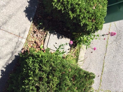

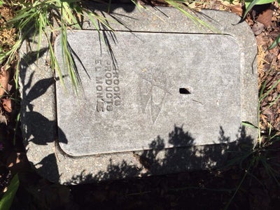

Step 2: Find Your Water Meter
Your water meter is usually somewhere outside your home where the meter reader can easily access it on foot. Look for a concrete, metal or plastic cover in your driveway or front yard, or somewhere near the curb. In this example, the meter is under a concrete cover nestled between two bushes adjacent to the street. The meter cover may be stamped with the name of your local water provider, in this case East Bay Municipal Utility District (EBMUD).

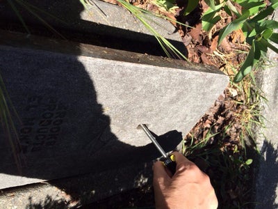

Step 3: Open the Meter Cover
It can be tricky to open the meter cover with your bare hands, as meter readers usually have a tool to do it. In this case, we use a screwdriver through the hole in the cover to pull it open.

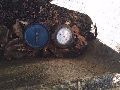

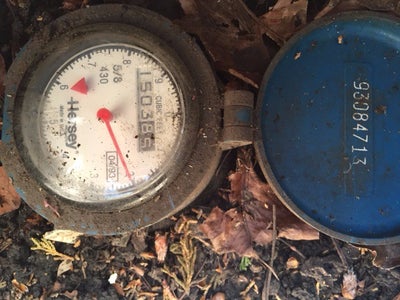

Step 4: View Your Water Meter
The water meter may be under a cap - open it. Inside you will see a gauge that may or may not be visibly moving. A tiny triangle (red in this example) moves more quickly and offers a finer gauge of motion.

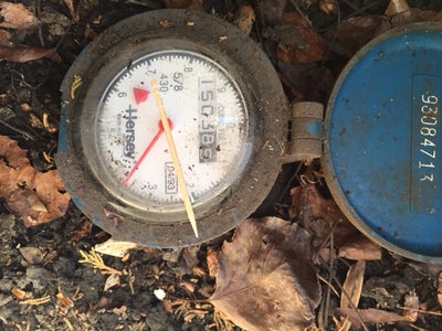

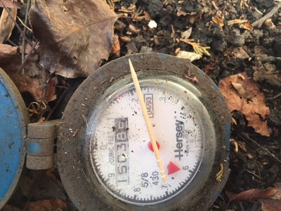

Step 5: Turn Off All Water in Your Home and See If the Meter Moves
Turn off all water in your home, including sinks, dishwashers, washing machines. Do not use the toilet during this test period.
After you turn off all the water, set a toothpick on the meter at the exact location of the arm. This is an easy way to tell if the arm has moved after a period of time.
Wait at least 20 minutes to an hour, and then come back and view the meter.
If you see that the arm is now in a different position, that means YOU HAVE A LEAK and there is water somewhere escaping your system.

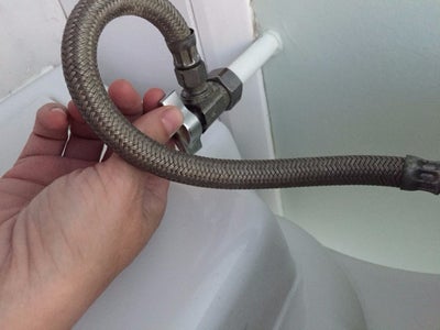

Check to see if toilets are causing a leak by shutting off the water supply to your toilet(s) and repeating Step 5.
If your meter stops moving during this time, you've determined that the toilets are leaking!
If the meter continues moving during this test, you will need to continue to check elsewhere.

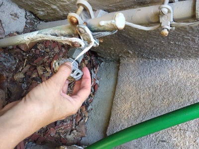

Step 8: Check Hoses, Under Sinks, and Under Hot Water Heater
If your home has additional shut-off valves that allow you to shut off portions of the home, use them to continue your process of elimination.
Here are some other common places to check for leaks:
  • Check outdoor hoses, and be sure that they are turned off at the faucet and not just at the hand-held valve. It's possible for hoses to lay in dirt or grass and drip water without the leak being visible.
  • Check under hot water heaters for a drip. These are important to catch early, as they can lead to a failure of the bottom of the hot water heater and a major water mess!
  • Check under sinks for puddles or drips.
