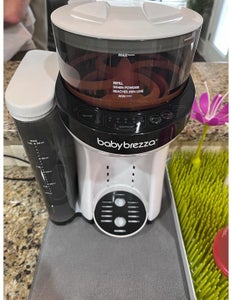

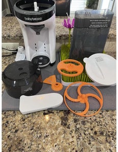

Step 1: Disassemble
- Remove powder container from the Formula Pro base and set aside.
(Make sure the funnel is properly connected to the base of the Formula Pro.)

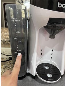

Step 2: Draining & Filling Your Device
-Place a container 20oz or larger under the funnel to catch water.
-After placing your container under the funnel, fill the formula pro water tank with 10oz of water and 10oz of vinegar.

-Unplug the machine, remove the funnel, funnel cover and water tank, dry them thoroughly and reinstall them to the machine.
-Your machine is now ready for storage. Pack the machine in its box, or enclose it in a bag and keep it dust free!
