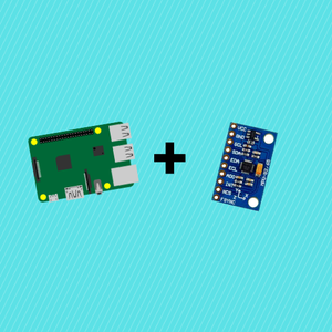

Discover how to capture magnetometer, accelerometer, and gyroscope data from the MPU9250 9-axis sensor using the Raspberry Pi. Although I'm utilizing the Raspberry Pi 4B for this guide, you can apply these instructions to any Raspberry Pi model that supports Python. By the end of this tutorial, you'll be proficient in sampling data and establishing a physical connection between the MPU9250 and your Raspberry Pi.

Step 1: Physical Setup
Connect your Jumper Wires to your Raspberry Pi as shown in the diagram above.
You can purchase Jumper Wires here. This is a simple I2C connection with power, you only need four wires to do this. I recommend a breadboard as well for these sorts of projects.
