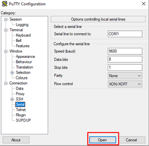

Step 1: Launch PuTTY
In the PuTTY configuration window on left panel, go to Connection>Serial.
On the Serial line connect to section enter the name of the port that you can see on the Device manager Windows and other basic settings baud rate, data bits, stop bits according to your device specifications.
Step 2: Establish a Connection
Click the "Open" button to connect to your device via serial using the USB console cable.
