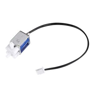

  • Vacuum pump Kit
    -Motor with the mounted vacuum pump
    -Electronic valve

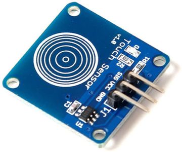

  • Capacitive touch button (or any other button module)

  • Connect power supply 6V (+) to the pump motor red wire(+) and Valve red wire(+)
  • Connect power supply 6V (-) to the pump motor black wire(-)
  • Connect power supply 6V (-) to relay pin(com)
  • Connect Valve black wire (-) to relay pin (NO)
  • Connect Capacitive touch button pin [VCC] to Arduino 5V pin
  • Connect Capacitive touch button pin [GND] to Arduino GND pin
  • Connect Capacitive touch button pin [SIG] to Arduino digital pin [8]

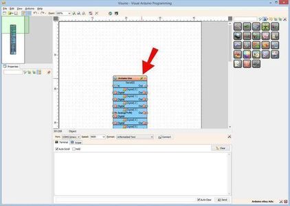

Step 3: Start Visuino, and Select the Arduino UNO Board Type
The Visuino: https://www.visuino.eu also needs to be installed. Download Free version or register for a Free Trial.
Start Visuino as shown in the first picture Click on the "Tools" button on the Arduino component (Picture 1) in Visuino When the dialog appears, select "Arduino UNO" as shown on Picture 2

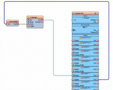

Step 4: In Visuino Add,Set & Connect Components
  • Add "Detect Edge" component
  • Add "Toggle(T) Flip-Flop" component
  • Connect Arduno digital pin 8 to DetectEdge1 pin In
  • Connect DetectEdge1 pin Out to TFlipFlop1 pin Clock
  • Connect TFlipFlop1 pin Out to Arduino digital pin 7
Step 5: Generate, Compile, and Upload the Arduino Code
In Visuino, at the bottom click on the "Build" Tab, make sure the correct port is selected, then click on the "Compile/Build and Upload" button.
