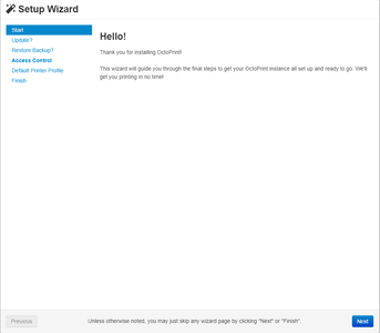

Once installed OctoPrint and the raspberry-pi boots up, it is necessary to proceed with the first setup in order to configure it properly according to the 3D printer you own.
Let's start by taking a detailed look into steps that should be taken in order to login and configure OctoPi.
Note that the Raspberry Pi and the device you are using to perform the login must be under the same network: it is recommend log into the interface of your router and check if both devices are in the list of connected devices. By default, the hostname of the Raspberry Pi should be octopi or raspberrypi.
  1. Type the device host name (usually octopi or raspberrypi) into the browser and navigate. It should appear the Setup Wizard that will guide you through the step necessary to complete the setup;
  2. Configure the Access Control. This is a mandatory step that allows you to setup a username and a password for the administrator account. The administrator has full access to both printer and OctoPrint's settings, therefore keep this information safe and protected.
  3. Set up your printer profile. This step allows you to specify general infos like printer name and some specific settings like print bed, build volume, axes speed/feedrate, extruders number and nozzle diameter.
  4. Finish. Congratulations! Your OctoPrint installation has been completed and now you are ready to go! Read all recommended advises shown in the last page in order to ensure your printer's safety.
At the end of the configuration the home page should appear.

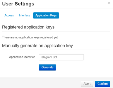

Step 4: Getting OctoPrint Application Key
This step is mandatory for setting up Telegram Bot. It needs an Application Key in order to send commands to OctoPrint.

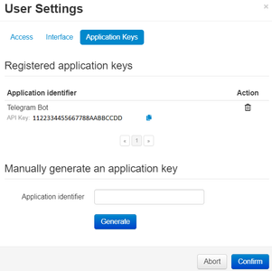

In order to generate and register an Application Key in OctoPrint you should click on the username on the right side of the Home page and then click on "User Settings". Insert the application name in the Application Identifier field and then click on "Generate".
Please take note of this key as it will be used in the following steps. You can always find it in the User Settings under the "Application Keys" tab. See this link for a video tutorial

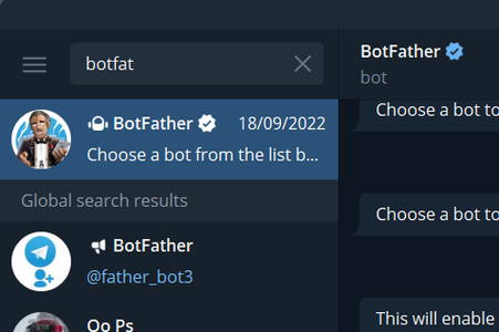

In order to create a telegram bot you need to use BotFather.
The first step is to start a conversation with BotFather through telegram, sending the "/newbot" command.
Then you need to choose the name and username to give to the bot.
When finished, take note of the HTTP API access token. As the OctoPrint Application key, it will be used to set up the Bot code.
