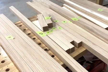

Step 1: Making a Cutting List and Hidden Storage
April made a set of plans with a cutting list for this build as a reference. She starts by cutting the needed parts out of hickory wood and milling them to their final dimensions. Each part is labeled with a piece of tape so April can find whichever part she needs. The four solid wood parts needed for the body of the hidden shelf are laid out while paying attention to which areas would be seen in the final product and being intentional about the direction it faces.
