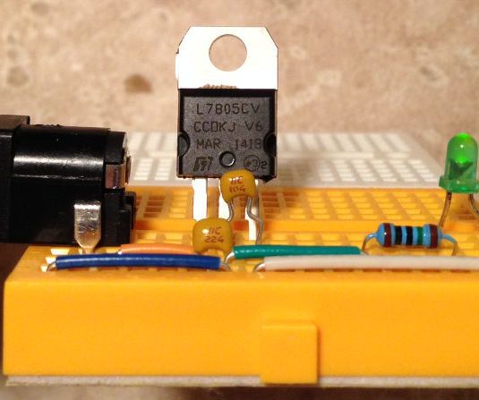

Step 2: Build the Circuit
Let's build the circuit on the breadboard. Start by connecting the power supply to the power rails on the breadboard. Don't power it until the full circuit is finished.
The ultrasonic sensor has 4 pins: Vcc, Trig, Echo and Gnd. To use it we’ll generate a high pulse on the trigger pin, and then the echo pin will generate a high signal which duration will tell us how long it took for the sound to go from the module to the obstacle and back. Connect Vcc to the +5V rail and Gnd to the ground. Connect Trig to the pin RA6 of the PIC (pin 15) and Echo to RA7 (pin 16). If you're using a different microcontroller, Trig should be connected to any digital output, and Echo to any digital input.
