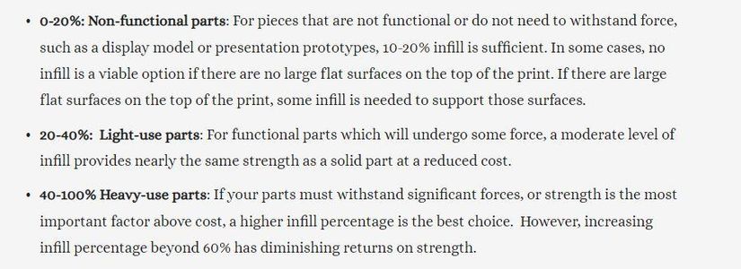

Because this Laptop stand will be manufactured by 3D printing. In 3D printing, usually you will not print a whole solid block, instead it's kind of hollow that has some infill matrix like picture above called Infill percentage. Usually the higher the infill percentage, the more force the 3D model can withstand.
Because of that, it is really worth drawing the force diagram to have an idea of all the forces acting on the structure. Picture of the diagram and top view of the design was provided below (I used my finished model just to help you guys easy to visualize, we will go to the design step next).
From my calculation, it seems like the vertical force on the Laptop Stand is around 3-4 N which is really light. So I think an Infill percentage around 15-20% is enough. To help you guys in future projects to choose a suitable infill percentage, I will include a link below, the 4th picture I took directly from that website:
Infill percentage guide

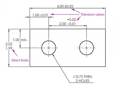

Step 4: What Is Dimension Tolerances
Tolerance is the total amount a dimension may vary and is the difference between the upper (maximum) and lower (minimum) limits.
Tolerance exists in every manufacturing, surface finishing processes such as CNC cutting, molding (used for plastic), casting (used for metals), 3D printing, laser engraving, welding,...
There are 2 types of tolerances:
  • Dimensioning
  • Fittings
The first picture I provide is the tolerances for dimensioning only.

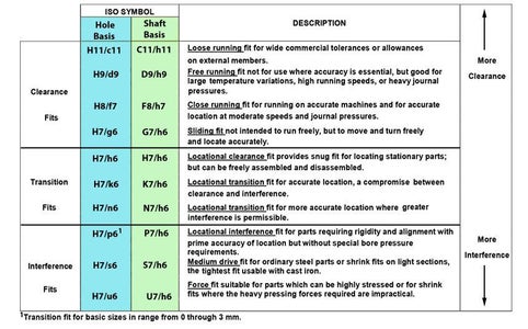

Usually the tolerances is not a problem unless we create holes and cylindrical shapes for fittings and tightening. Imagine you want to do tight fitting between a cylindrical shape and a hole. The hole has inner diameter around 15 mm, and the cylindrical shape has diameter around 10 mm, resulting in a really loose fitting.
  • As you can see in the 2nd picture, this is my past project, the fitting inside the black circle was really really loose, and it didn't function well as tight fitting.
Another problem may arise is when your hole is around 15 mm but your cylindrical shape is 17.5 mm. At this point, you cannot fit the cylindrical shape through the hole anymore.
  • Usually in professional engineering, they have a chart for tolerances in holes and fitting, usually denoted in letter. You guys don't need to know this as it is really rare for non-engineering major to used and really pain in the ass.
Believe me, when I'm in my Engineering drawing class, we have to study this chart and memorize it @@.

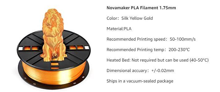

Step 8: How to Find Tolerances for 3D Printer?
After you finishes your model, now you start to account for tolerances in your design:
So from what I understand, the printer we use is the 3D PLA printer. So the tolerances in those machines depend a lot on the tolerances of the filaments. For ex, look at the Novamaker filament, you see they have tolerances 0.02mm, it means that in this filament, the true diameter will be in the range 1.75 +- 0.02 mm. So if you buy 100 filaments of Novamaker, the true diameter will fall between 1.73 and 1.77 mm.
  • Varying in diameter will affect the dimension of the object too.
  • Of course, for each filament, they have different tolerances. So make sure to ask your 3D printing technician in advance to account for tolerances in the design. As you see, Hatchbox has tolerances around 0.03mm.
Understand more about 3D printing tolerances.
Another way for you to check for tolerances is via trial and error. Simply said, you have a hole with diameter 15 mm. And said you want to create small cylindrical shape that tight fit with this hole. You will start with 13 mm, if it's not fit then go for 13.5 mm, 14 mm and 14.5 mm until you feel the degree of tightfit is suitable for you. As you can see, I print several cylindrical with sizes from 13 to 14 mm just to see how it fits with the hole. Because I'm the man of realistic, I never 100% believe on the parameter provided by producers.
  • As you can see for my 13 mm cylindrical shape, there are a lot of spaces, which makes it loose fitting while I want tight fittings. So I have to increase my size a little bit to reduces the spaces.
  • For 14 mm shape, the spaces actually negligible, so I would say around 1 mm is the tolerances for this 3D printer machine.

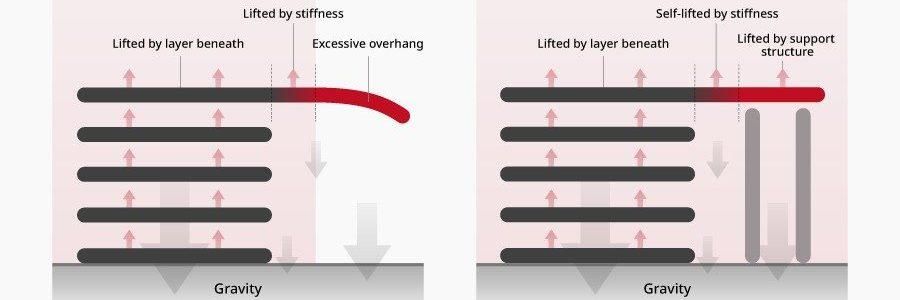

Step 9: Support Features in 3D Printing
Actually, from step 6, 1 reason why 1 mm is the good tolerance for my cylindrical shape is because of the bad surface finishing from support structures in 3D printing.
So Support feature in 3D printing is the added part that supports the overhanging structure that needs to be removed after printing. As you can see in the 2nd picture, when you have overhanging feature, due to gravity, the hanging feature will fall down, causing your 3D design to be incomplete.
Read more about support structures
For my cylindrical shape, because if it is printed in vertical direction, due to the ratio of height/ diameter is too high, the model will face overhanging, leading to distortion in shape. That's why they have to print it in vertical direction, adding supporting features. I did not take the picture of the supporting structures, so I draw a quick 3D models to let you know how the supporting structures look like for my cylindrical shape.
  • After finishing my 3D cylindrical shape with supporting structure, that part needs to be cut away, thus it results in really rough finishing like this, which is why it affects tolerances a lot.
