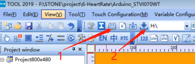

Step 20: Generate Configuration File
Once the UI design is complete, the configuration file can be generated and downloaded to the STVI070WT-01 displaye.
First, perform step 1, then insert the usb flash drive into the computer, and the disk symbol will be displayed. Then click "Download to u-disk" to Download the configuration file to the usb flash drive, and then insert the usb flash drive into STVI070WT-01 to complete the upgrade.

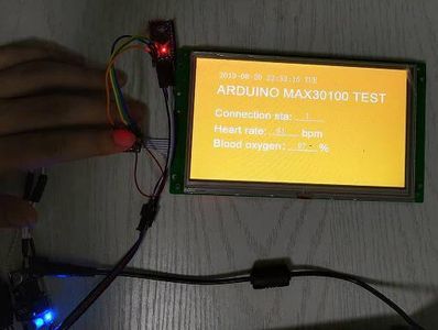

Step 31: Display Heart Rate on the LCD With Arduino
Compile the code, download it to the Arduino development board, and you're ready to start testing.
We can see that when the fingers leave the MAX30100, the heart rate and blood oxygen display 0. Place your finger on the MAX30100 collector to see your heart rate and blood oxygen levels in real-time.
The effect can be seen in the following picture:
