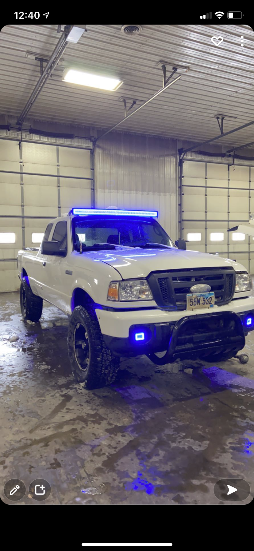

Hi my name is Gavin Haubris have you ever needed an oil change but don’t have enough money to pay someone else to do it well here I am going to show and tell you the easiest way to do it by yourself.
