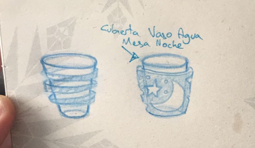

When I go to sleep, I turn off the light, go to bed and then it usually happens that I want to drink water, so I have to turn the light on again to find the bottle of water. Thinking about this problem I started thinking about using a glass and making a 3D printed cover that would glow in the dark. But then I thought that perhaps I could do the same to the bottle that I always use and with that I would solve the problem of having to turn the light on again.

After having the original idea, I created the element that covers part of the bottle and I used it at night. I was very pleased to find that I solved the problem I had of finding the bottle in the dark but then new problems appeared, I didn't know where I had put the cap, or where I should put the bottle after drinking water.
So in this instructable I'm going to teach you not only how to create the bottle cover, but also the coaster and the cap piece.
