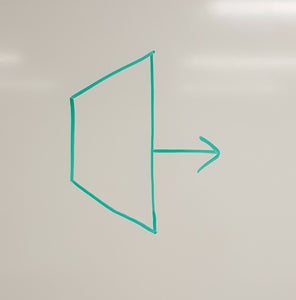

Step 1: Draw a Picture.
For problems such as these, it is good to draw a picture so it is easy to see what is being said in the problem statement. Since the problem ask to find the power of a turbine, draw a turbine. It can be illustrated as a trapezoid with the long side facing to the right. Engineers have picked this illustration because it shows them power is being produced, which means work is coming out.
Note:
Drawing the picture is only a reminder the work is being done by the turbine so it should be a positive value. After you draw the turbine, you will not have to do anything with the picture.
