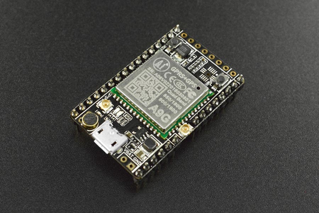

Step 4: Prepare the A9G Board
Refer to the connection diagram to ensure proper setup and connectivity between the A9G board and your computer.
  • Refer to the connection diagram to ensure proper setup and connectivity between the A9G board and your computer.
  • If the COM port is not automatically detected by the application, you may need to manually trigger it. To do this, press and hold the PWR button on the A9G board.
