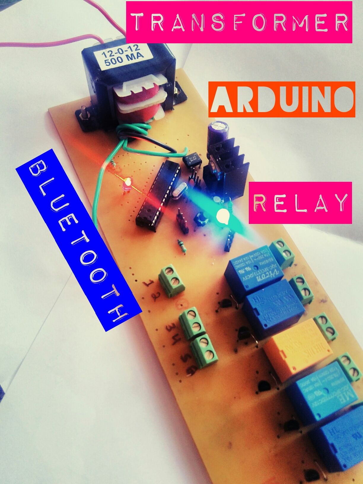

Create your own circuit board based on your requirement,my board has 4main circuit , 1)5v regulator 2)3.3v regulator which is required for esp8266 module ,4)relay module use transistor as switching device
