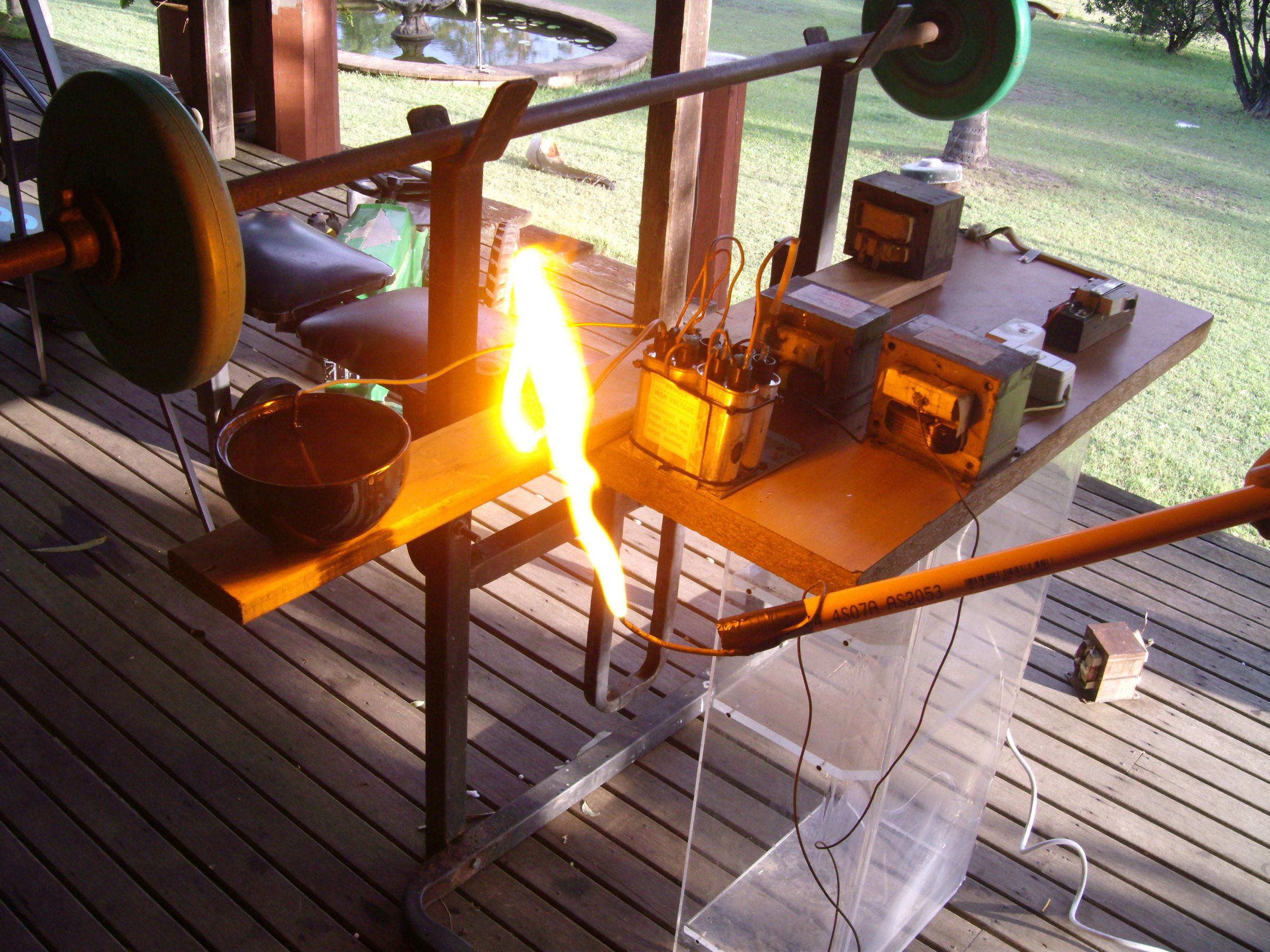

also pictured below is what you should have, but in the pictures I have not yet removed the shunts. (the primary connections are on the opposite side.)

And of course a video. 2-3 turns approx 3v AC and around 500 amps of steel melting power...
Heres a snapshot of one rewound MOT i put a bit more effort into. I wound it into a power supply that has 5 voltage taps which once rectified the voltage on each is 0v (GND), 12v, 24v, 30v and 50v DC! all of the voltages besides the 50v can put out 30 amps+ and the 50v limited to around 20 amps.
