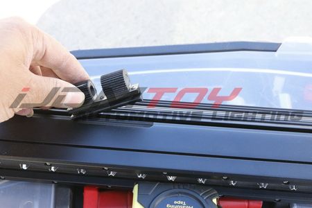

Step 1: Prepare Your LED Light Bar for Installation.
Assemble the rail mount base piece into the slot in the middle of the LED light bar. Lock in the rail piece exactly 5.5 inches from the edge using the included hex tool. Further assemble the rail mount by placing the M10 bolt in between the base piece. Slide in the longer M8 bolt through the rail piece and the M10 bolt. Secure with the spring washer and nut included.

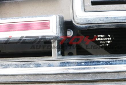

Step 6: Install the Exclusively Designed LED Lightbar Mounting Brackets.
Unscrew the two bolts located behind the emblem on both sides using a 10mm wrench. Pull back the piece that was held by the screws to clamp in the LED light bar holding brackets. Bolt back the screws through the second hole of the L-shaped support brackets.
