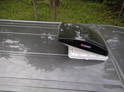

Step 2: Install Painter’s Tape and Mark the Fan Cutout
Step 3: Drill 4 Holes at Each Corner (large Enough to Let the Jigsaw Blade Through), Cut Each Side, Then Apply Duct Tape to Retain the Panel From Falling at the Last Cut
Step 4: Break the Sharp Edges With a File and Smooth the Edges With a Fine Sandpaper
Step 5: Install Hein’s Adapter (if You Are Using It), Install the Fan Flange and Drill All Holes
We used 4 c-clamps to ensure nothing moves during the process.
Break the holes sharp edges and smooth with a sanding paper.
Clean the surfaces to be touched-up with isopropyl alcohol
Step 6: Apply Primer, Paint & Clearcoat on Fan Cutout and Drilled Holes
This is an important step to avoid corrosion in the future.
TIP: You can have your exact van color prepared for you in almost any auto-parts store. Just give them your color-code (printed on the driver’s door frame), year of production and make.
Step 7: Clean the Fan Flange With Acetone As Per Manufacturer Recommendation
Clean the van sheet metal with isopropyl alcohol as well
Step 8: Apply Putty Tape on the Fan Flange (on the Surface That Will Be Mating With the Fan Adapter)
Step 9: Apply GE Sillicone II on Hein’s Fan Adapters Surfaces That Will Be Mating With the Van
This is to prevent moisture retention and corrosion.
Step 10: Assemble Hein’s Adapter (if You Have It) and Fan Flange All Together With the Fastening Hardware
We used washers both on the interior and on the exterior surfaces.
We did not oversize the holes on the interior fan adapter. With the butyl tape and sealant, it was difficult to re-assemble…
Step 11: Apply Dicor Self-leveling Sealant Around the Periphery of the Flange
We ensured to cover the van panel, the fan adapter and the fan flange. We also covered all the screws.
Step 12: Install the Maxxair Unit Through the Fan Flange and Fasten Using the 4 Provided Screws
Step 13: Look at Our Fan
Just look at it.
