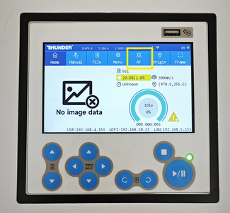

Step 3: Focus the Laser
Proper focus ensures clean cuts and crisp details. Depending on your machine, you can use auto-focus for flat surfaces or manual focus with a focus stick for more precision. Adjust until the laser is at the correct height above the material.

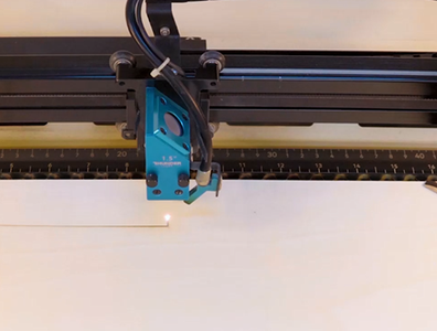

Step 5: Start Laser Cutting
Start the laser job and carefully monitor the process. Watch for any smoke, material movement, or unusual sounds. Keep ventilation running to reduce smoke marks, especially when engraving wood or cardboard.
