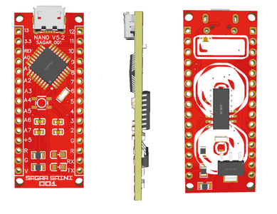

Step 1: Project Info
Hello guys, in this tutorial we will discuss about Arduino circuit and share its Gerber files and bootloader info with you. We will construct the circuit using EasyEDA. Then we will convert the schematics into Gerber file. This PCB cannot be designed using homemade PCB fabrication method; therefore, we will use JLCPCB (China pcb manufacturer) to get professional PCB just in $2.

Step 4: Component’s Description
ATMega328p is the main microcontroller unit and 16mhz crystal with 22pf capacitors are used to generate proper clock.ch340g is used to program this Arduino chip using TXD and RXD pins, 22pf capacitor with 12mhz crystal oscillator is used for proper clock in ch340g. Here we are using micro usb to power 5volt directly from mobile charger, 100nf capacitors as filters can reject the distortion frequencies (if generated). 1k resistor are used with TX and RX pins. 10k resistor is used as a pulldown resistor with reset tactile switch. Ams1117 regulator with some capacitors gives stable 3.3volts and 5volt output. Smd led indicates the power input.

Step 7: Burning Bootloader:
We will upload Arduino UNO bootloader in this blank Atmega328p-au chip. To burn bootloader, follow these steps and watch our video on YouTube.
1) Connect the original Arduino Uno to your pc using cable.
2) Now upload the ARDUINO ISP code in this Arduino from examples.
3) Connect the 2nd Uno according to this schematic.
4) Just change the programmer to Arduino as ISP and from the tools option click on burn bootloader.
5) After burning bootloader safely, now we can use our own Arduino as original one.
