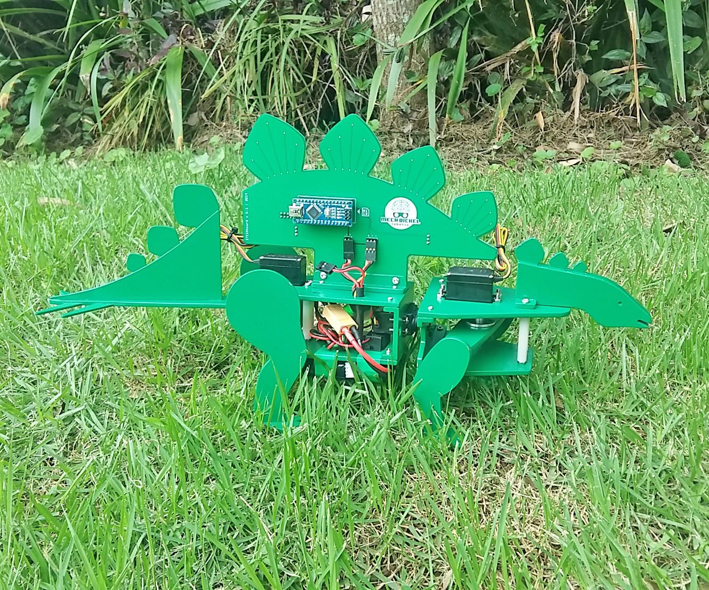

1. For this tutorial, I created PCBrain, which is a brain-shaped PCB, based on my YouTube channel logo.
2. The focus of this tutorial is to show you how custom shapes can be made easily... so, forget the simplicity of the PCB itself... it's more artistic and just an example of a shape.
