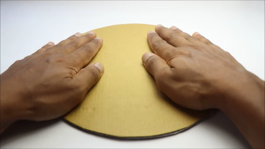

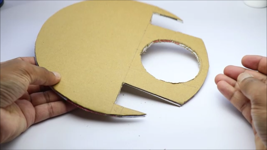

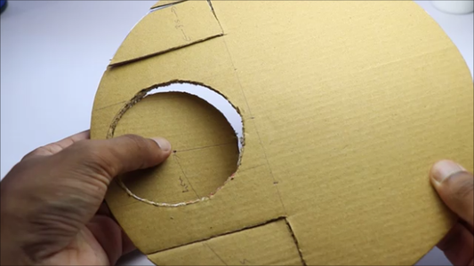

Step 1: Frame
This is an important part of our project as it holds all the electronics and the mechanism, You may think why am i using cardboard instead of other materials like wood?
The answer is simple, Like you think cardboard is weak indeed it is not true in this case.
I'm using a cardboard that was recycled from a package container and to make extra sure about the strength i used 2 pieces that were joined together with paper glue.
Even though one layer would provide good strength i didn't want to take a chance!

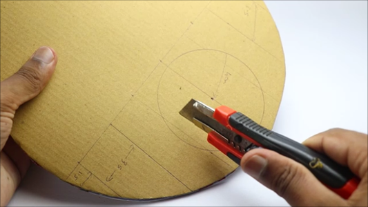

I made discs of 2 cardboard and later cut it using paper scissors, These individual pieces were later glued with paper glue and allowed to dry completely, Once this portion was complete i marked the area where the fan would be sitting and also made space for the wheels.
You can see the measurements that i used and follow the same if not you will have to spend some extra time to get everything right on the first place.
After you cut along the marked areas our base is ready for use and we will head over to next steps to add components here.

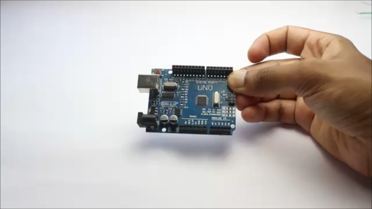

Step 2: Circuit Diagram and Codes
To make the circuit understandable for everyone i will give a step by step explanation for each component
There are 4 main parts Ultrasonic sensor,Uno, Motor driver and the Fan part

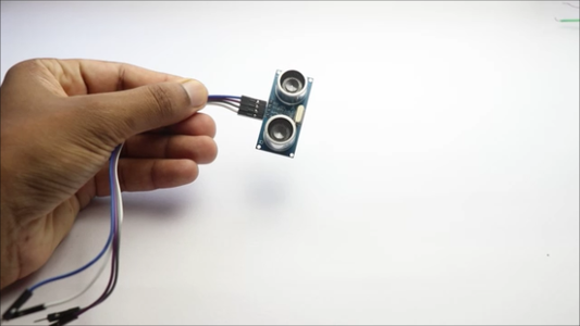

Ultrasonic Sensor or HC-SR04
  • VCC to 5V on Arduino
  • GND to GND on Arduino
  • Trig to Pin 8 on Arduino
  • Echo to Pin 9 on Arduino
Arduino uno connection with motor driver and battery
  • The Vin pin is connected to 5v pin of the driver
  • Gnd to Gnd of driver
  • 12v pin to positive pin of driver
L298N Motor Driver connections with Uno
  • IN1 (in21) to D4 on Arduino
  • IN2 (in22) to D5
  • IN3 (in23) to D6
  • IN4 (in24) to D7
  • ENA (enA) to D10 and ENB to pin D11
  • VCC to Battery positive
  • Motor 1 Outputs to Motor 1
  • Motor 2 Outputs to Motor 2 Terminals
Fan
  • The DC fan that we are using needs 12v to operate at its maximum power
  • Since I'm using the fan directly without any speed controller i will be using a 7.4V battery source
  • To make a connection all you have to do is connect the battery to the DC fan and to control the on and off add a simple on and off switch
This completes the circuit part, Now connect the USB to arduino and open ide, Copy and paste the below code and click on upload.
After the code is done uploading disconnect the USB from the board and proceed with the next step.

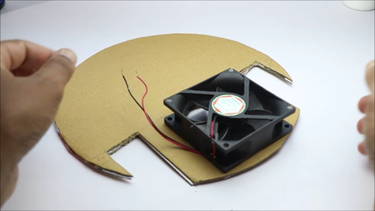

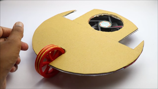

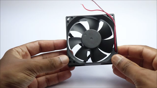

Step 3: Suction Fan and Front Wheel
After we have the frame ready i will begin with FAN part, This DC fan uses brushless motor and is very fast so there should not be any obstacles in its path.
To ensure this i have made hole on the frame that is slightly larger than the size of fan, Use glue to attach the fan body to the frame and seal if any excess holes are in the fan body.

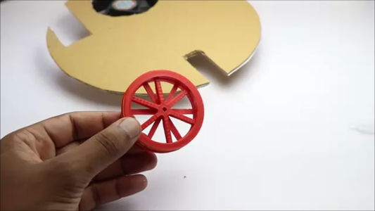

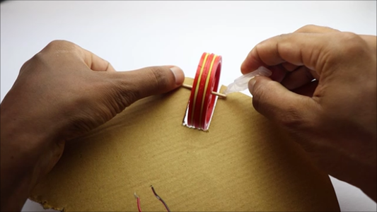

For the movement talking about the back side we have 2 BO motor that control the front, back, left and right movements.
There is no chance this robot will be steady with 2 wheels so we need additional wheel, Instead of making this robot more and more complex i decided to use a simple wheel that is installed on the front part.
I had a wheel to which i added toothpick in between to move smoothly. The ends of this stick were coupled with superglue followed by hot glue.

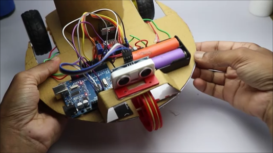

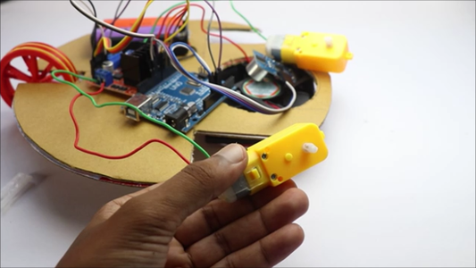

Step 4: Adding Circuit
One thing that you need to keep in mind that whenever you are working with the circuit fix it firmly to the base this is because when we are handling with more circuit connection the chances of missing one or more connections is more common and searching for that missing connection will cost you some time.
In my project i made the size of frame in such a way that everything will fit as needed, I will glue the electronics first, use double sided adhesives for arduino uno.
Now add the BO motors to the base and glue it using the hot glue, make sure that glue is not too hot this may disfigure the frame of motor.
Add the wheels to the shaft of motor and repeat the same for other side too
In the bottom part i will add the power source for the fan, You can see that i have connected 2 batteries in series and connected to fan via switch and it is secured with a zip tie.

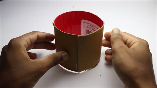

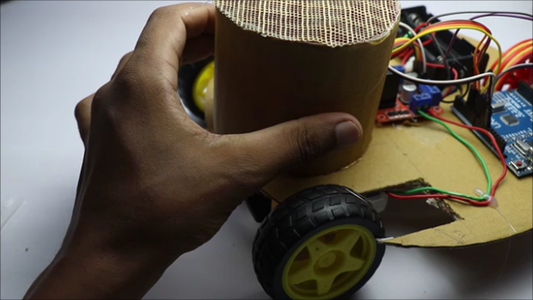

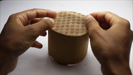

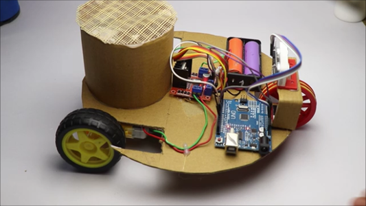

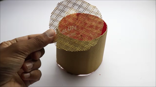

Step 5: Suction Cylinder
This is the important part in collecting the objects from the ground, You may be thinking why this is so easy looking and how the objects will be collected?
Like i said earlier the DC fan is powerful enough to gulp all the lightweight material from the floor and as soo as it picks up the object is airborne, Now we need something that will keep the object somewhere.
This will be taken care by a plastic mesh with many holes that filter out the objects and allow the normal flow of air hence do not disturn the function of the DC fan
I made a cylinder with cardboard and sealed one end with the mesh and the other end was glued to the frame using hot glue

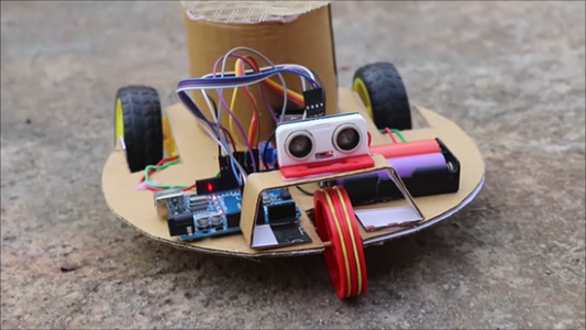

Step 6: Finishing and Testing
After you have done all the steps make sure all the parts are intact on the frame and there are no loose wires, This is because the robot car undergoes lots of movements when its working.
Plug in the battery to the case, First turn on the suction fan switch and then the main circuit switch.
At the time of testing on my studio i placed hand in front of the sensor and the car moves back, so on its way i placed some bits of paper, If you have made everything like i did the bits of paper will be swallowed by the fan.
And yeah! the project is finally working like it used to be, You can try dropping some light weight objects like pieces of foam or hair and see the magic of this robot.
Thanks to the large capacity battery used in both the circuit and the fan it gives a great backup so you can trust this robot to clean away most of the mess on the floor
Note that this robot can pick only light objects and no liquids or larger size objects can be picked!
